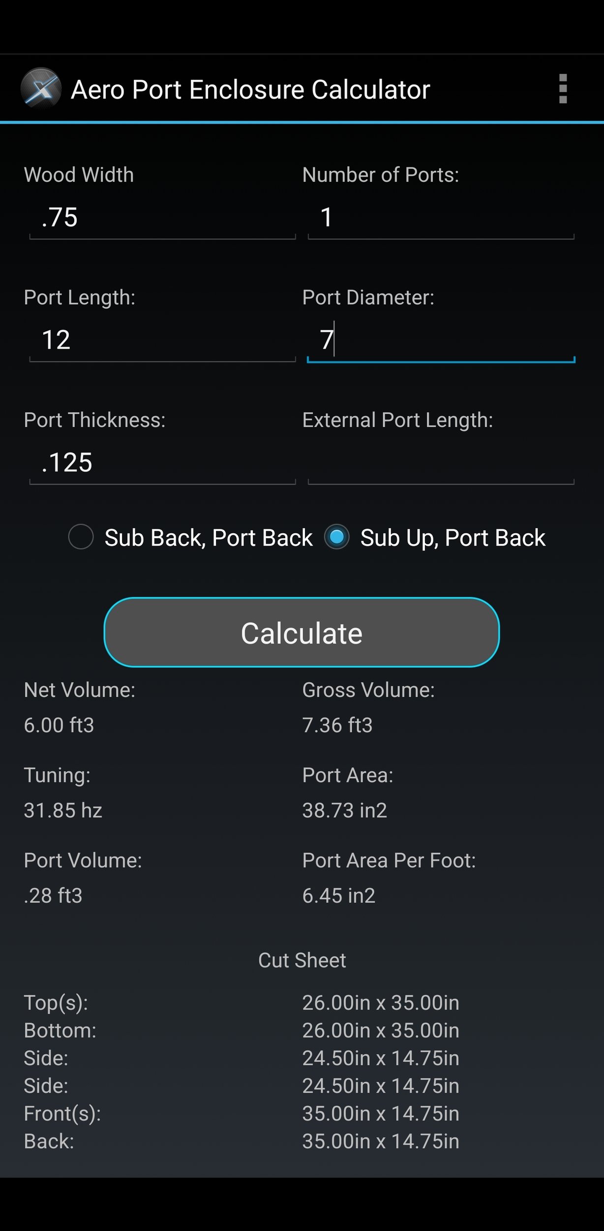

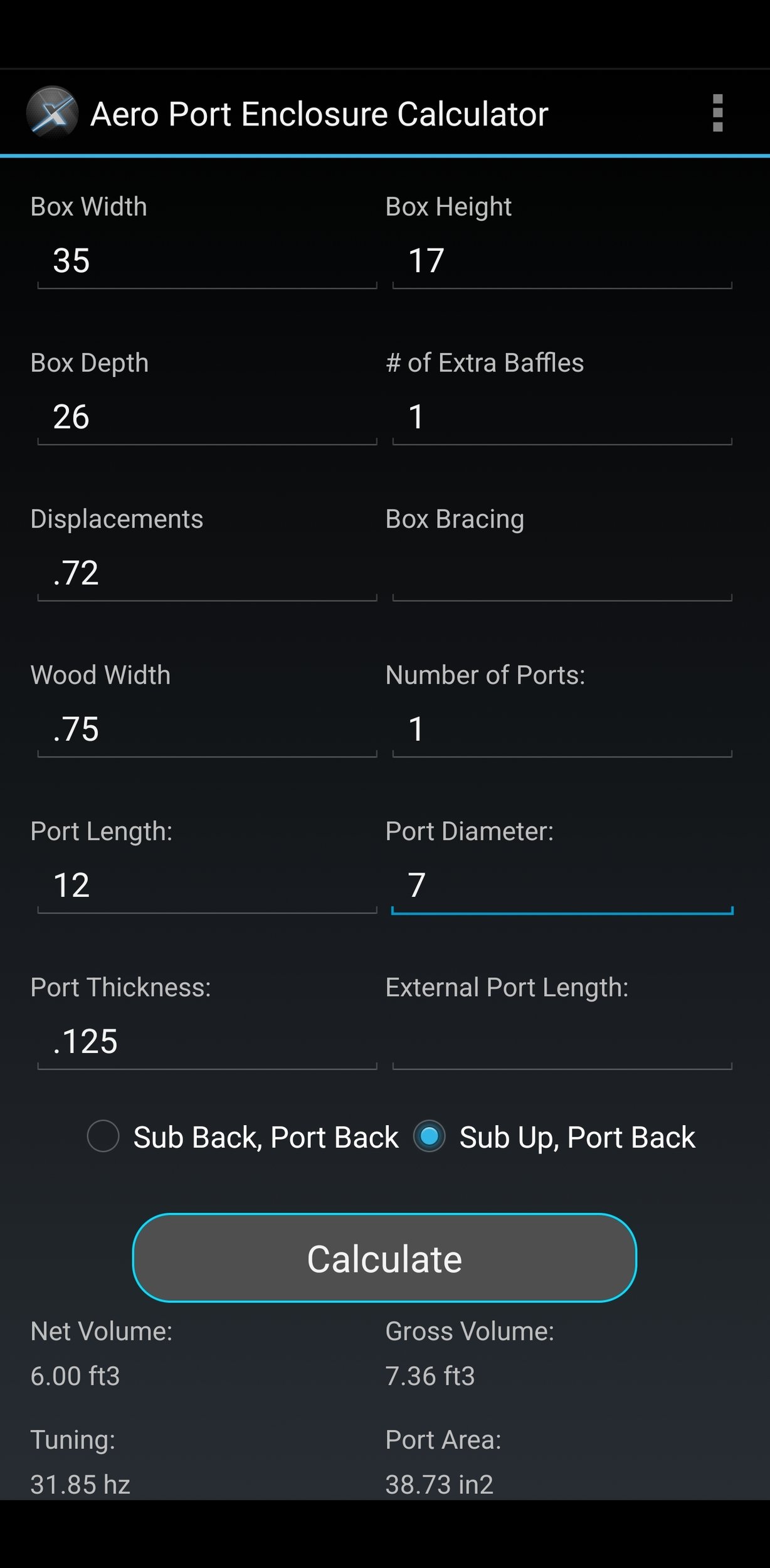

6 cube max. But it's a tight fit less than 1/4 inch tolerance all around.
This is the best case scenario:

That's too small for four 12's. You better go four 10's. Just sayin. Having 6 cubes of room is different than building a 6 cube box and being able to put it in your vehicle. I've seen some boxes altered or tossed because they couldn't get them in the vehicle.
Do an 8inch port or 2 6s 7inch aeros don't exist.
Also 4 10s 12s won't work. Not enough airspace
It'll fit with 4 DC Audio level 4 12's. They need 1.25 cube ported.
And I know what you're talking about with the angle of insertion into the trunk. I calculated that as well. It's gonna fit easy.
The dimensions above aren't the dimensions of the actual trunk. They're the width and height of the trunk opening plus what the triangulation of the insertion will allow. So yes, I can put 6 cube if I wanted to.

Well you do you I think that 4 12s is going to be pretty peaky and have a fairly narrow bandwidth. I don't run 12s under 2cubes each maybe 1.75 each in shared chamber. I don't even put 10s in less than 1.25 each.

Try and get 5 cubes after port and sub displacement.
