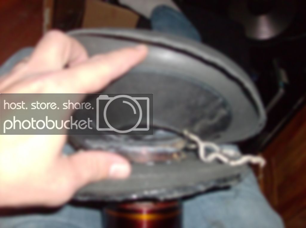

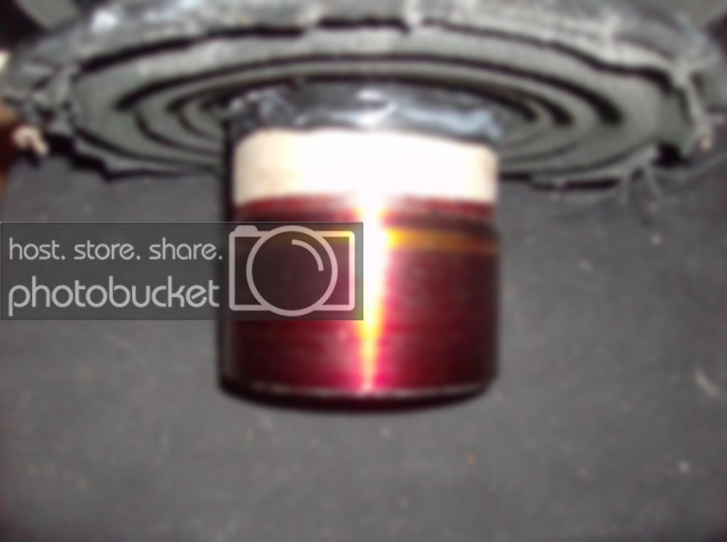

im guessing the problem is just too much power. ive never been able to make a sub do that. when you cut it out post pics of the coil...i bet its pristine.
really thats all you can do is stiffen it up. as far as getting different parts....i wouldnt know where to begin.
Rusty says that he's only seen this kind of excursion from 2 guys with lvl 5's. Fortunately I'm a vid nut so I document it!
Pics of .7 coil and cone after launching it!
Coils still nice and prestine:eek://content.invisioncic.com/y282845/emoticons/cool.gif.3bcaf8f141236c00f8044d07150e34f7.gif
