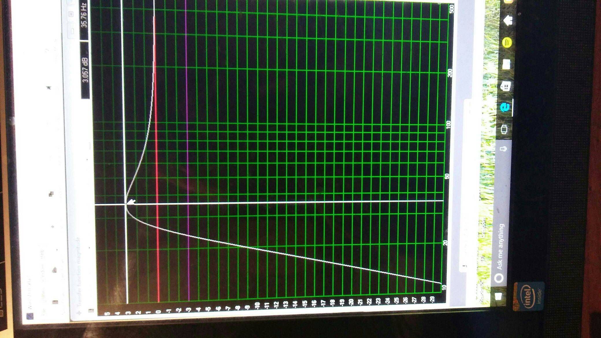

Well since you guys had me rethinking my decision i decided to try and check it out myself on WINISD Pro and came up with this. With a box with the interior demensions of 35.5 by 22.5 by 21.45 tuned at 28Hz id be getting this as my output which seems like it has a good all around response for pretty much any rap/decaf music if im not mistaken. Like i said this is all a first time experiance for me so i could be wrong. Whatcha think?

Almost 10 cube may be too big for that Sundown. They're normally designed to function in smaller boxes. Try going down to 7 or 8 cube and see if that tames that peak a little for you (going down to 8 cube shouldn't sacrifice much output).
You will get a peak from the vehicle in there somewhere around 50hz, what I find really ugly sounding is a valley in between a low tuning peak and the car's resonance. I'd far rather have an even rolloff on either end sacrificing extension than say 30hz really loud, 50hz really loud and 40 really mushy sounding.
Also if you really think you like whale songs you could probably get away with tuning even lower.
On the bright side, once you have seen what response to expect then get a feel for how it plays real world you'll get a better idea of what you like and what to change when and if you switch things up.
Ok thanks for the input when i get off work ill hop back on WinISD and mess around with the box size to see what i can come up with. Is the vally caused by the box being too big? Still learning

The "valley" is going to appear because you have the 3dB peak @ 30hz then you'll get another peak between 47 and 54hz (wherever your vehicle resonates). Without knowing where you get that peak from your vehicle's cabin it'll be hard to plan around.
The reason I say smaller box is that I know sundown designs around smaller box. Play around with box volume and watch that peak. From 4 cube to 6 cube you'll notice a lot more gain than 6 to 8, then even less from 8 to 10. There's a point where you lose a lot from going smaller and a point where you don't gain much from going bigger. The sweet spot is in the middle somewhere.
Alright awesome, i know my blazer resonates at 51Hz from what ive looked up. Ill toy around with it and see if i can find a good middle point
