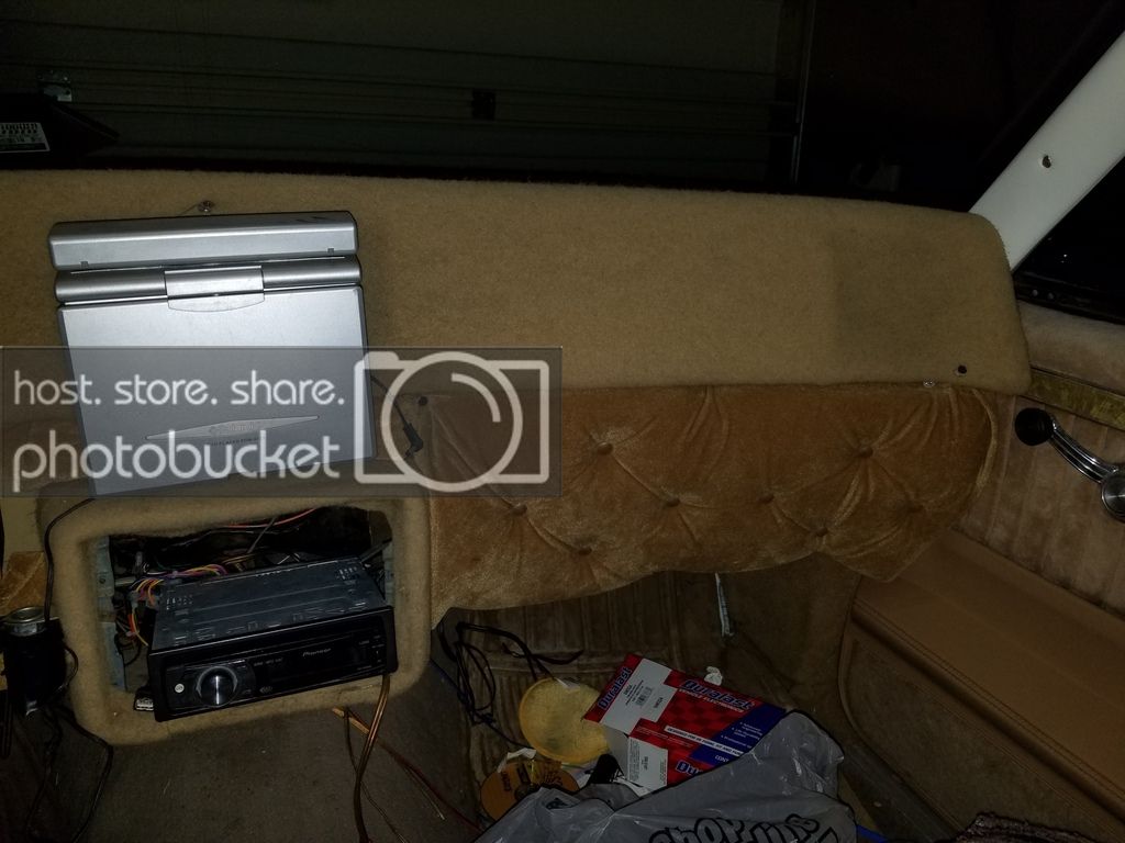

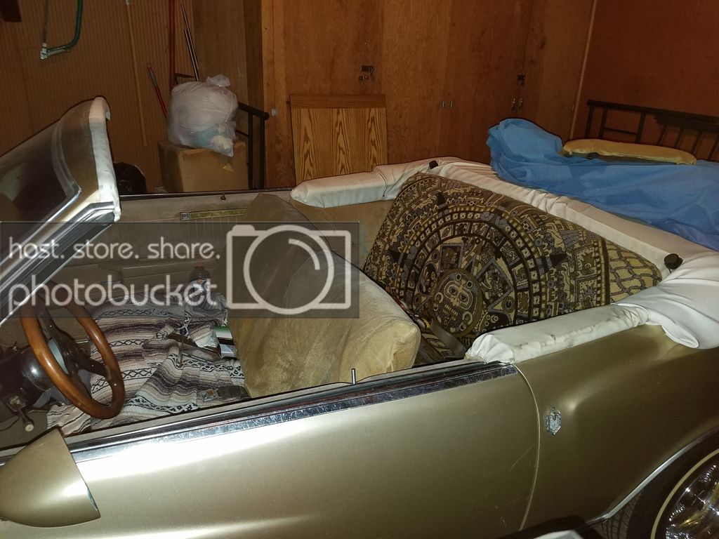

I'm looking to upgrade the sounds in my weekend cruiser, a chopped top 78 Monte Carlo. Am I limited to what speakers would sound good due to no top and placement of the speakers? Really Not trying to do any cut outs in the interior if possible..
the fronts I think are 3" speakers mounted in the dash, it's behind some fabric covering.. there's no holes in the doors and no place in the back so i have 6x9s in boxes on the floor behind the seats.. I will also be looking for an amp to power the speakers. For now the HU is an older pioneer DEH 4000U .. subs are 2 SA8 v3s on a TS 1.8k
Budget is around 500 for speakers and amp, preferably used.. right now got stock electrical but will upgrade when my other car is sold
