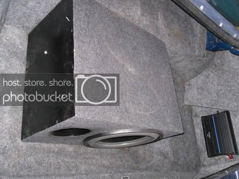

My GFs car has 1 15" and about 600wrms going to it. Low budget Pyramid PW1586x 15" Powered by an Orion Cobalt CO600.2. Bridged to the sub @ 4 ohms. Box is 3.75 cf net @ 30hz.
Pretty loud for a girl, it kills the lows. Louder than alot of my guy friends systems, lol. Girls dont need much to be happy as far as bass goes it seems. Dont sleep on the pyramid either, **** gets down and dirty on 600w.
Trunks kind of dirty, but her car gets used for taking off garbage and getting groceries, as i have too much bass in my trunk for that stuff.
