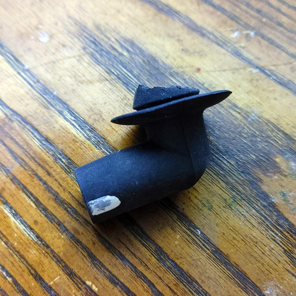

Just replaced a 6" section of sunroof drain hose. It had butyl rubber on it for some reason. I thought it was for some shoddy repair. I examined the section I cut out from the inside but saw no cracks or holes. Hmmm. I drove around with the A/C on for a bit. No more dripping in the floorboards from that at least.

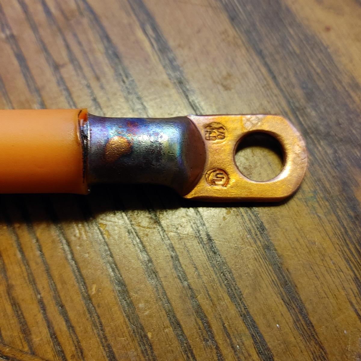

I am so aggravated. I have no clue where all my heat shrink is. Anyway, this is the power supply side of the 1/0awg OFC cable that will run from the circuit breaker to the JP630 Ultra Cap Bank. 300a breaker at the beginning and a 300a fuse just before the cap bank. From the cap bank to the SMD fused distribution block to a 300a fuse to the amp. I was under the Equinox today so I looked for a good place to hang the cable and there are PLENTY of perfect options.

I found out that the puddle of water in my drivers floor board was from the sunroof... sort of. I repaired the drain hoses so I figured shes good to go. Nope. Heavy rain, puddle. So I taped the sunroof with waterproof tape and waited for a storm. No puddle. This means it has to do with the sunroof. I inspected the drivers side hose since the water was on that side and found that in the dash where the tube connects to the firewall the rubber grommet was broken. Water was dripping down the firewall into the floor.
This is not an accessible area to repair without literally removing the dash pad and dash. I had to work through some small holes created by removing the corner of the dash pad and removing the a-pillar cover. I pulled the hose out with the broken piece, brainstormed then came up with my plan. I had some left over hose from the repair on this same tube so I pulled off the grommet and placed a 3" length of hose on the tube. It took 45min to finagle the hose into the hole in the firewall but I got it in. Made some adjustments and secured the new custom drain hose/tube.

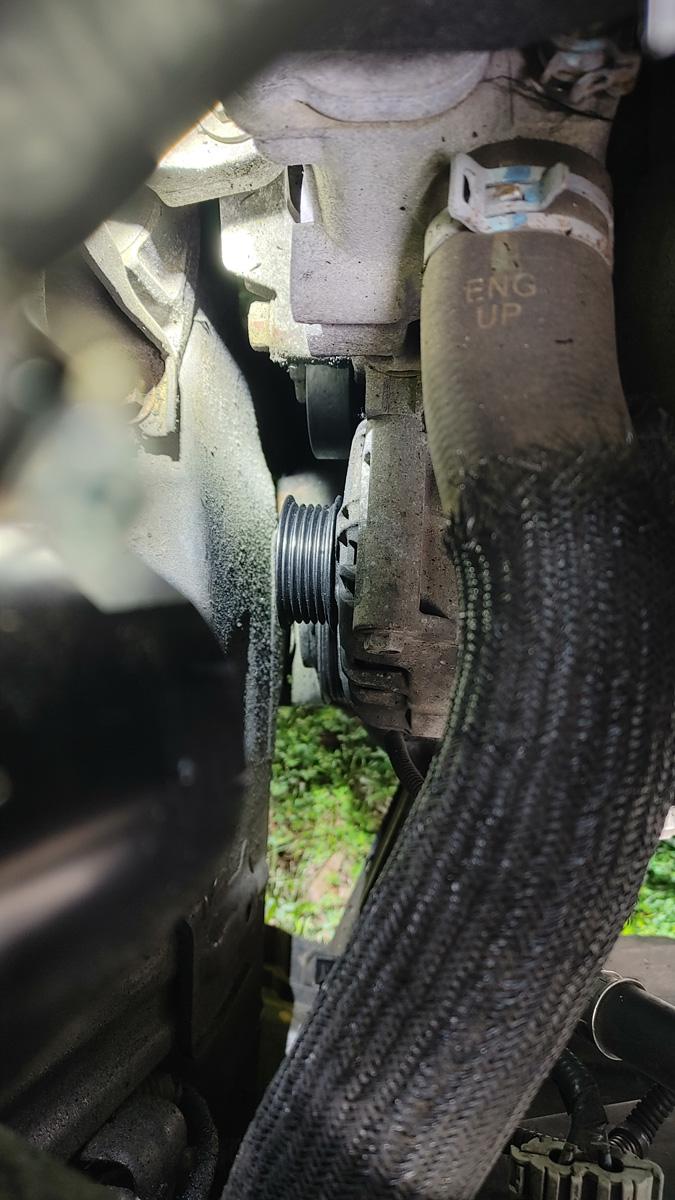

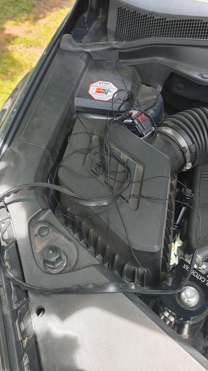

Heading home from the DMV after chillin in line for literally 4 hours to finally switch my DL over to NC. Anyway, running up I85 at 85mph zippin the Equinox in and out of traffic and I come to my exit so I exit. My A/C starts blowing warm and a red battery light shows up on the dash. I shut off the A/C and lower the volume on the radio and lower my window. The car is running perfectly. I get home and pop the hood and find the destruction!!! On a side note, the XS Power battery is seriously bad ***.
