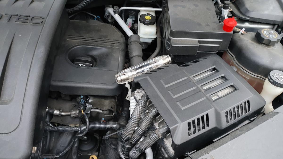

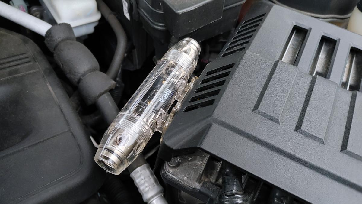

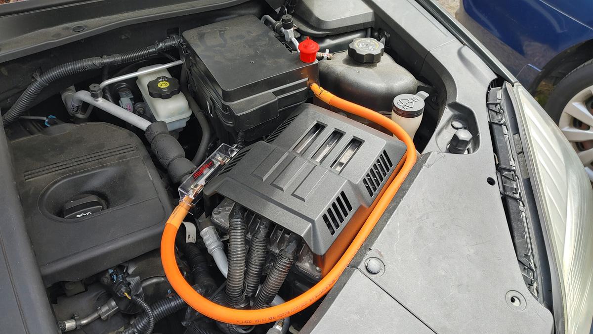

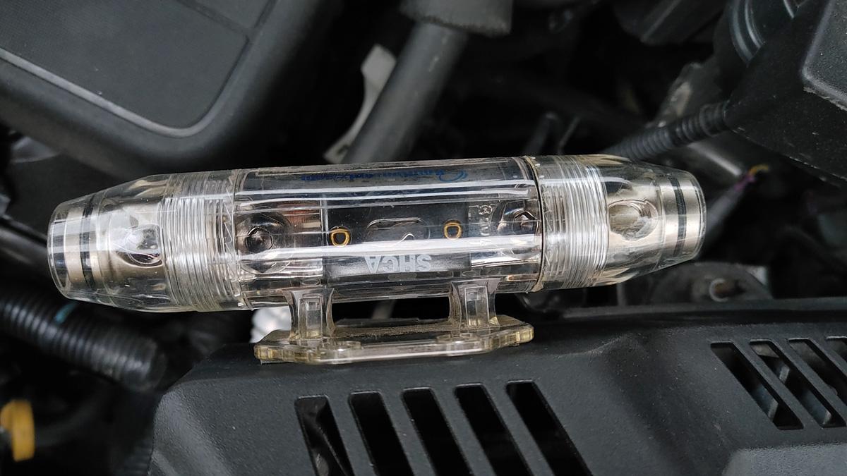

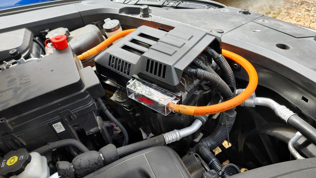

Would you believe it took 3 days to decide to mount the fuse holder there? 350a fuse. I have 300a and a 250a fuse as well. I think the JP77 calls for a 300a fuse.

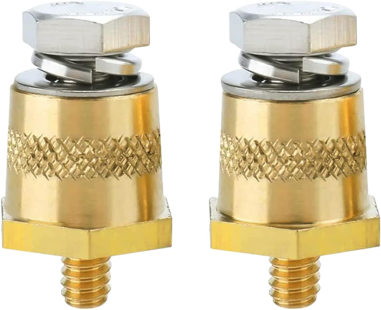

I have to measure my battery box to see how much extra room, if any, I may have. My Equinox takes a BCI Group 47 battery however a BCI group 48 is listed on a few sites as fitting my vehicle as well. I looked it up and the 48 is like 1 inch longer than the 47. That is all. All other dimensions are the same given the same battery manufacturer. I am leaning towards the XS Power Group 47 AGM. or 48. Mostly because they have M6 terminals and I want to run brass top mount terminals with bolts in the top of each terminal for my 0awg cables from the alternator to the battery to the jump start terminal where my orange cable is connected. It will make more sense when I run it all.

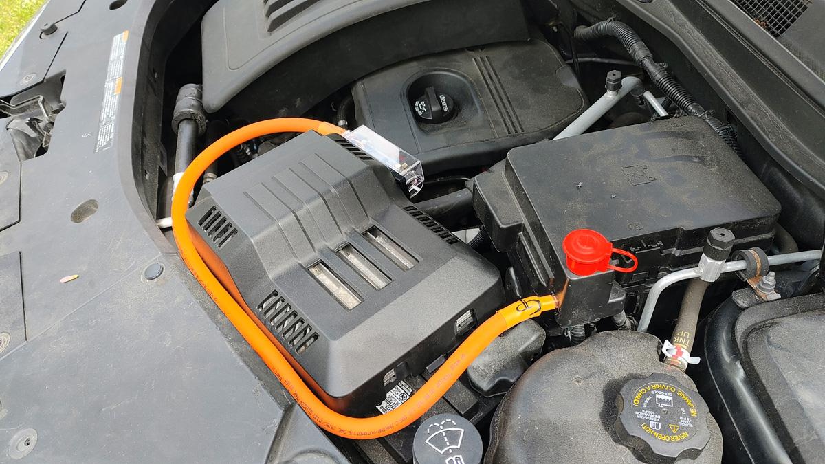

I may just say screw it and drill my holes through the underside of the car to the cargo area in the rain tomorrow. One hole for the 0awg power to enter and one hole for the 0awg ground cable to exit. I am going to ground to the frame.
