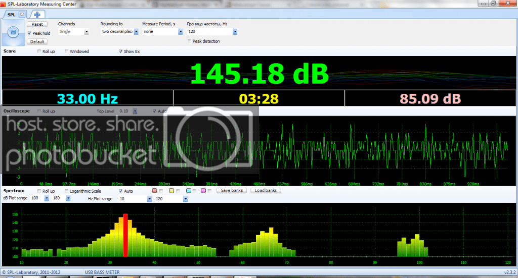

best so far, not bad for less than 500 watts //content.invisioncic.com/y282845/emoticons/cool.gif.3bcaf8f141236c00f8044d07150e34f7.gif
That should be close to a 148 on 1k, turned it up yet?//content.invisioncic.com/y282845/emoticons/cool.gif.3bcaf8f141236c00f8044d07150e34f7.gif
I could wire to .5... but im enjoying 2 ohms lol. Id try for the b1 record, but the b2 record is quieter lol.
tested more today... couldnt get more than the 145.18, morning it averages 144.5ish, midday and night after its been in the sun all day it meters about a 141.5. really amazing how much the temp of the vehicle matters. but ive got some plans, so hopefully Ill see that 150 by sunday.
