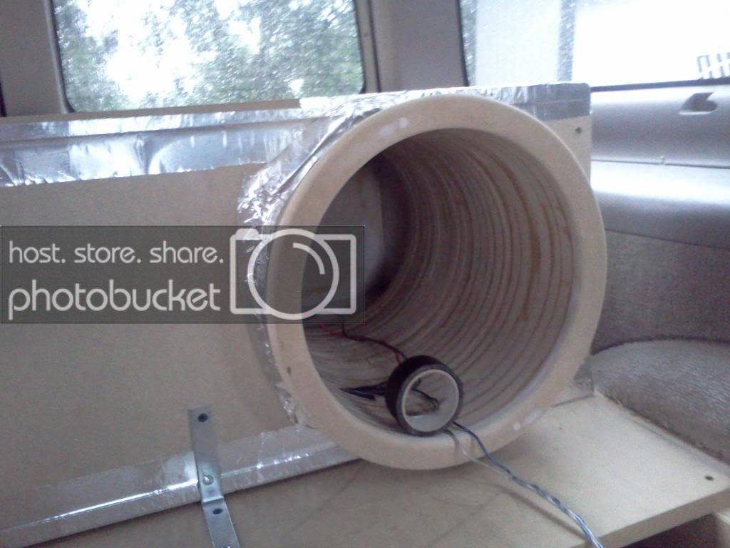

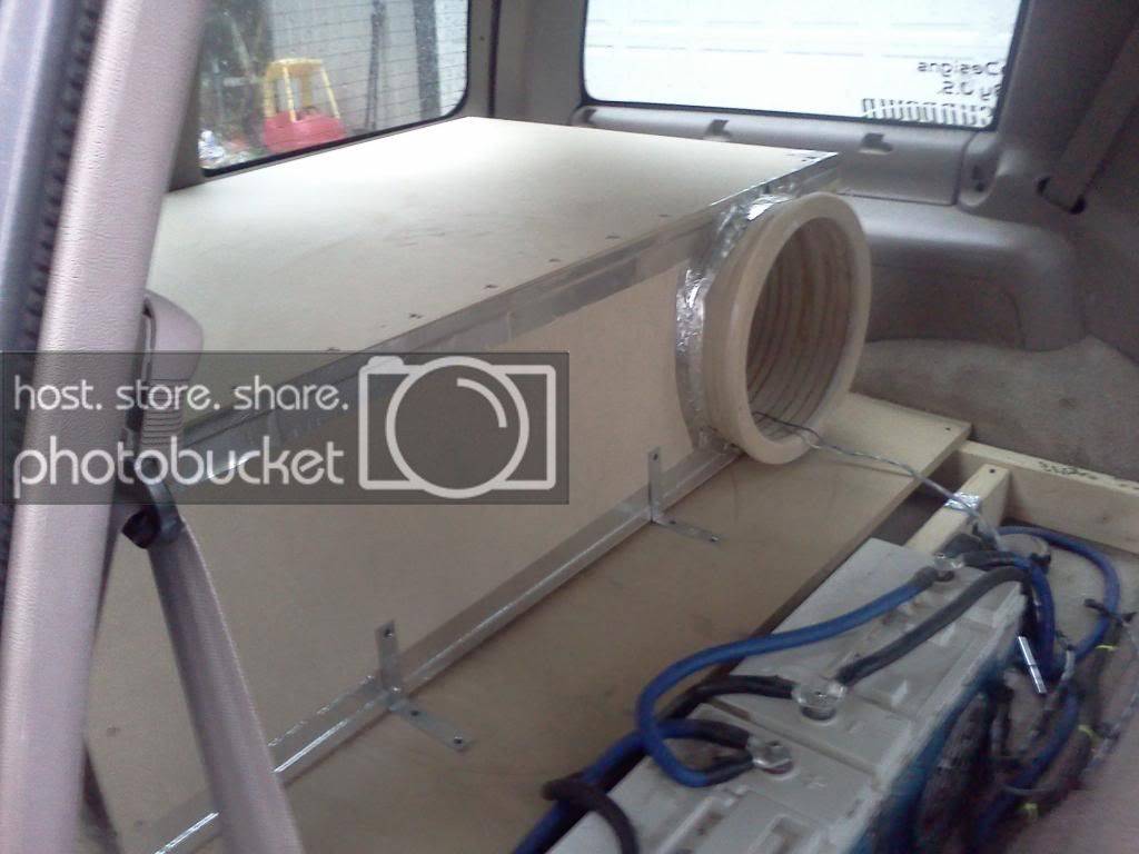

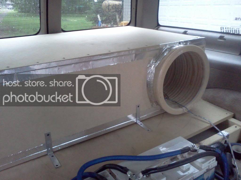

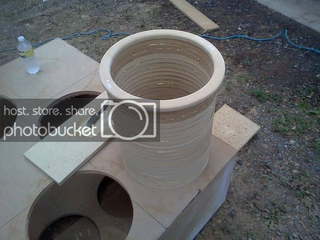

I got the port made, and I got it in, just for temp yesterday so my buddies could here it. I still have a lot of work to do, but its coming together... should be an easy 50, but sealed will be a different story. so heres some pics.
dat port area... it plays music quite well, which is to be expected, but it does some nazzty burps fur sure. I have lots of testing to do.... lol. plus I still have to finish the port!

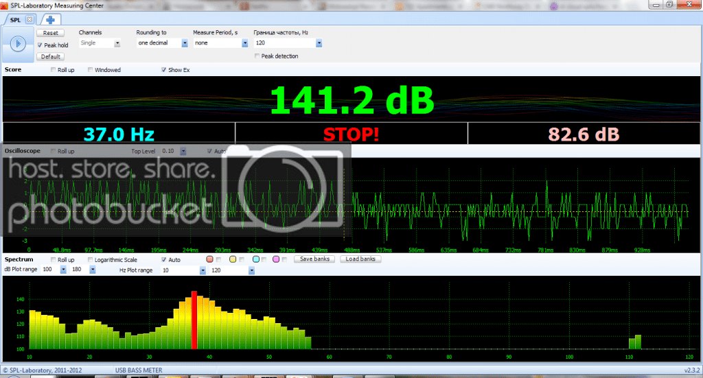

I got my first set of numbers today, this is drop in, no testing, no deadner etc. Im wired to 3 ohms, rising to about 6 or 7 ohms. No clamp numbers because I cant find my clamp. I know it is well under 1000 watts though. I want to say that its about 6-700 watts, but like I said, no clamp, so im not going to say anything. But its not too bad for music, vehicle sealed, meter is at the MWSPL location song is juicebox.

I need to shorten my port, to cause a resonance spike, I will gain quite a bit im sure, I may shrink down the front too. this tahoe is hard to get loud in with such little cone area and power, but its doing okay, its a burp box, that im playing music with, I just cant find any tones lol
What's your rear Fc?
45, and im not going smaller, I will throw the surrounds if I do. and yes, I know tune to the Fc is what you SHOULD do, which I did to begin with, but, if you tune above the Fc, it will cause a resonance spike. which I need for a burp situation.
I was jc. Just getting the picture. You can't beat testing.
