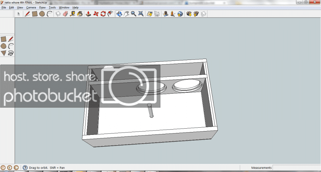

One guy was running almost 8 cubes with 4 12's to achieve the Fc he wanted. I understand that, but for most I wouldn't feel comfortable doing that even if the numbers did match up. If it was my box, wouldn't be a second thought about it because I know how to spot problems. That's why bandpasses are fun. Trying to get the best performance while trying not to mechanically destroy your woofer. Maybe that's the name of the game.
one thing I learned, small rear chamber=more port larger rear=less port. Im as small as I want to go rear chamber wise, but I still only have like .25" of excursion, now, since I have a large ratio, the woofers arent pressurizing the enclosure as I wish they were, thats why im chopping the port down. That will give me a higher tuning, and more excursion at my peak.
smaller chamber = higher Fc. The higher you tune, the higher your vent mach is given same power and port area. So it makes sense why your port velocity would increase when you shrink the rear chamber based on that logic.
