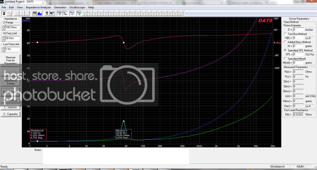

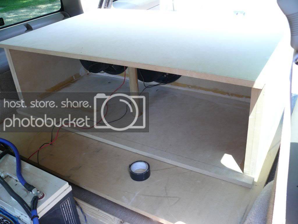

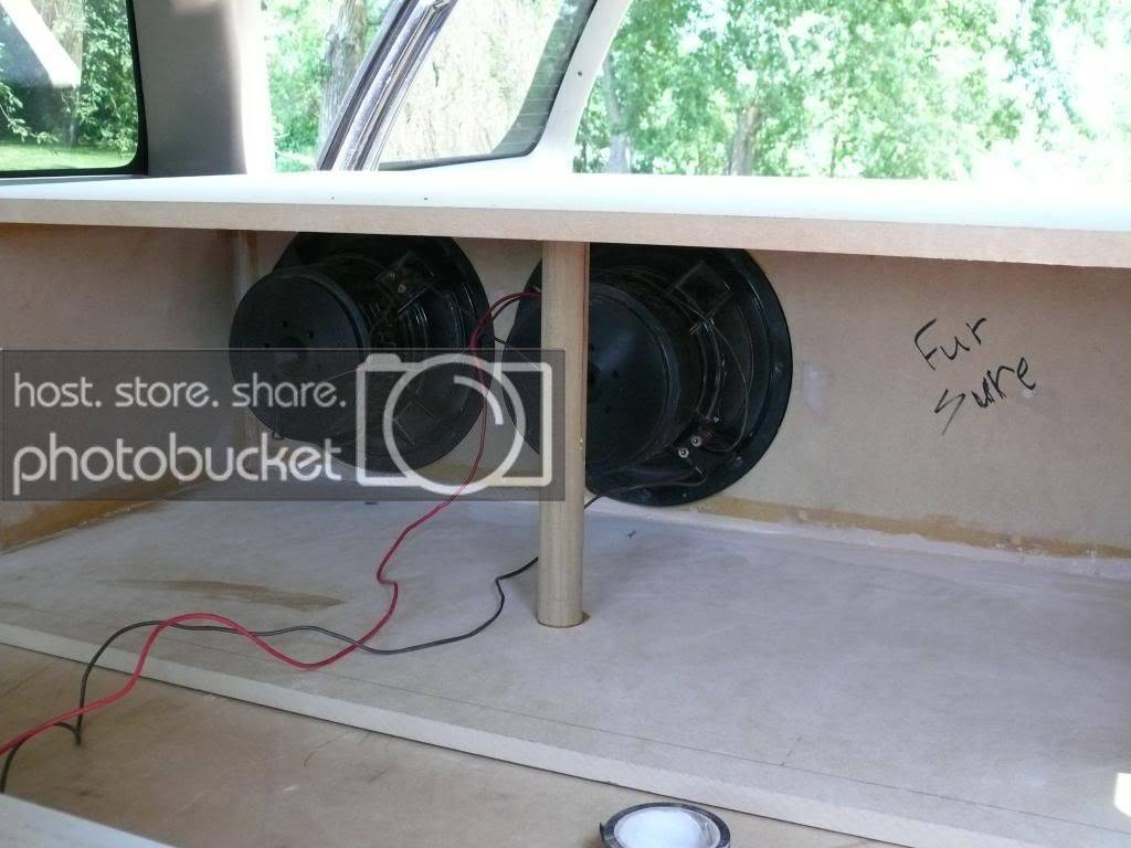

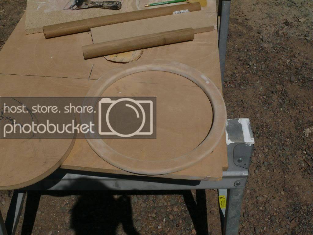

heres the beginning of my current 4th order. I will be making a 12" aero, that is what the ring is for. here is the Fc of my rear chamber. Measured with the vehicle sealed and the loading wall off. Its just about right where I want it to be.

Anyway... why don't you go into detail about how you arrived at the graph and the tuning for the box you posted for those who don't know. And why we tune to sealed resonance.
And how one might arrive at tuning without a "Woofer Tester."
