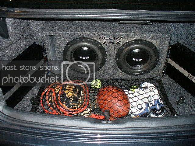

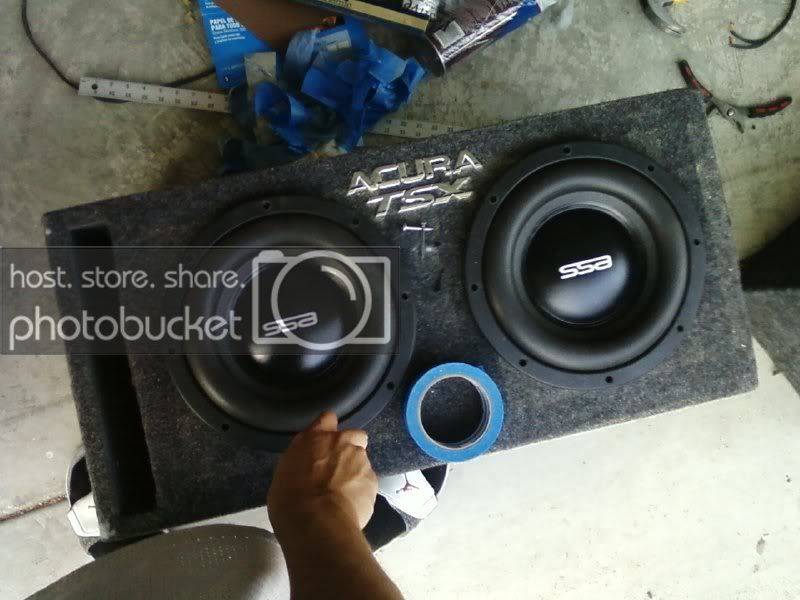

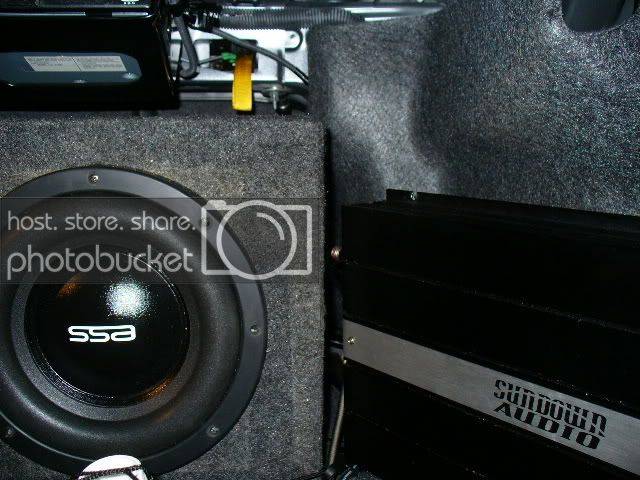

Switched the 2 ssa icons in 1.9cu ft sealed into a 2.25cu ft @ 33hz with ~1lb polyfill
Very happy with the sswitch. thing gets beastly on the lows. a bit louder than the 15" treo ssi that i had in 2.5cu @ 32hz with 800watts, and much much much more precise. It tried listening to trance/techno in the ported and it was able to keep up very well!
Running these at 1ohm off a sundown 1500D
with the sealed box, i was able to get to my spare easily, with this new box, i need to loosen a few screws in order to get to it, but it's all worth it!
I think it also looks a lot better since it's pretty flush with everything

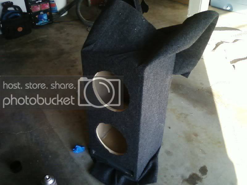

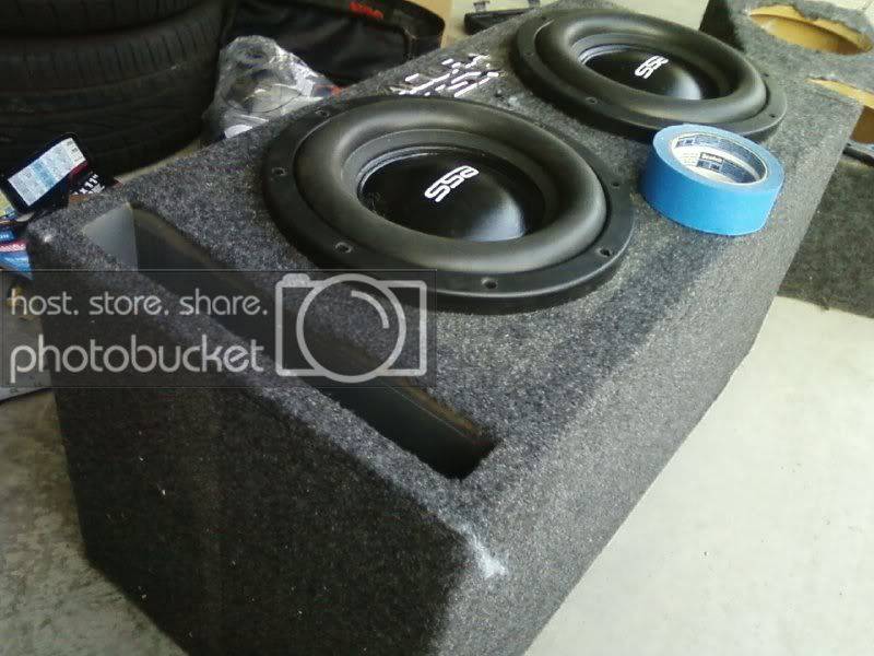

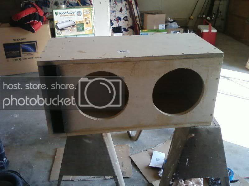

here's a few pix from the camera phone

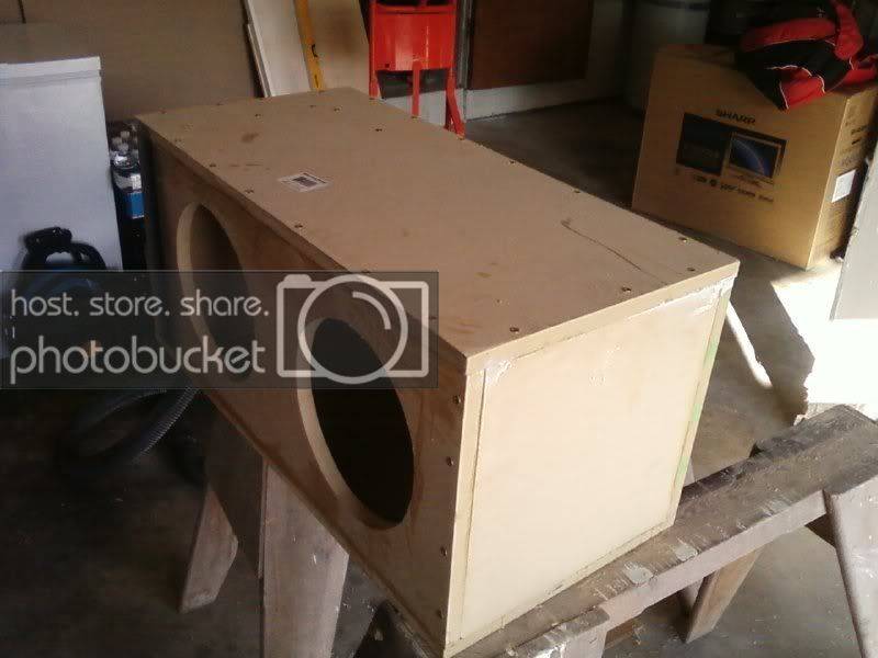

glued + screwed + caulking... since i didnt want to deal with any air leaks again
(If anyone has any suggestions for carpeting the side seams a bit more unnoticable, please do share //content.invisioncic.com/y282845/emoticons/smile.gif.1ebc41e1811405b213edfc4622c41e27.gif

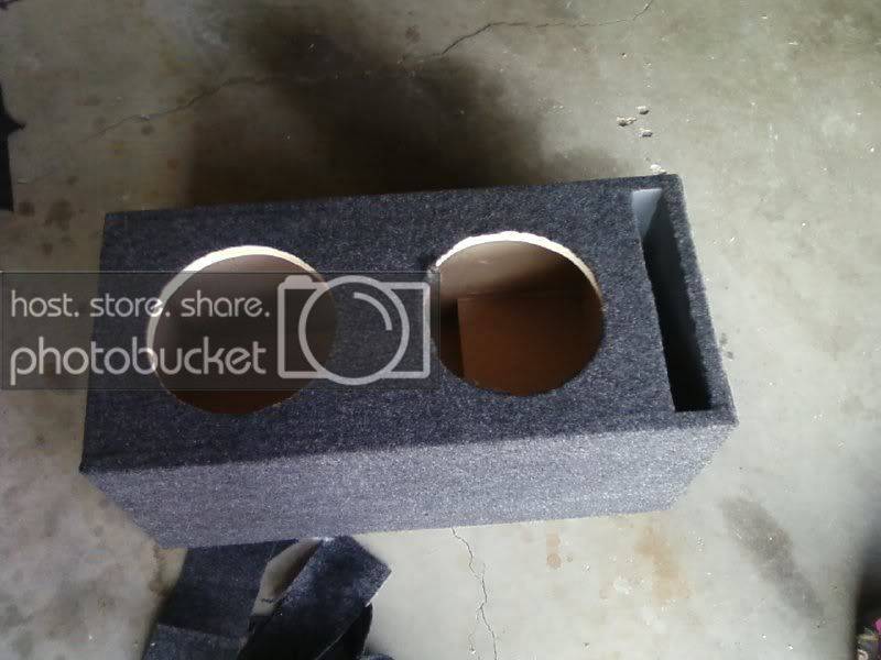

port painted gray to match everything else.. or try to
carpet

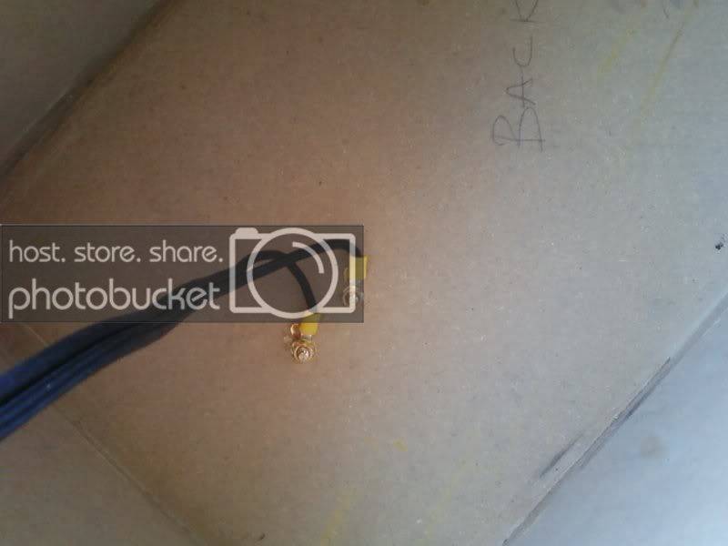

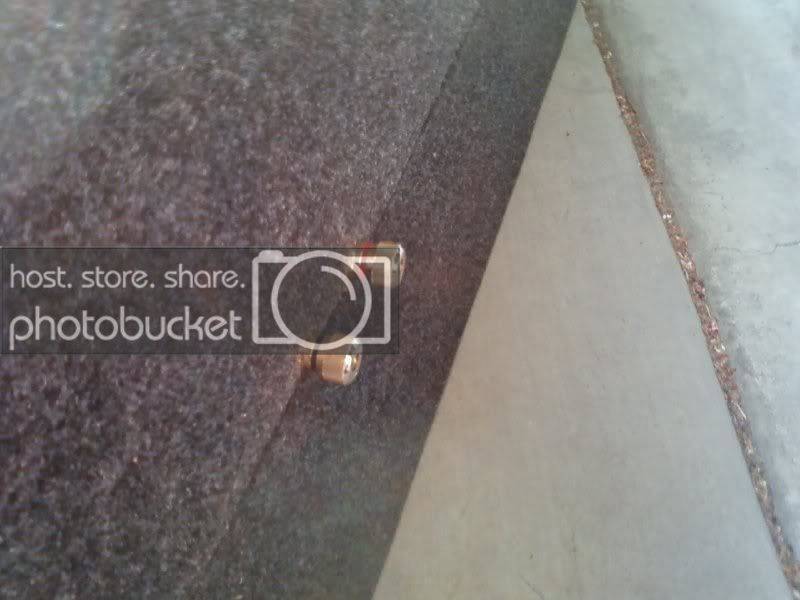

gotta love these binding posts!
Very nice...but probably would have made a larger port..
he wanted to keep the box as close to 2.25-2.5 ft^3 as possible and still tune to around 33 hz, so I got it around 2.25 ft^3, so we had to sacrificed a little size in the port, it didn't sacrifice performance just means that he'll have less port noise and still get the low's he desired. btw great job on the build. happy to see another DIY'er finish a nice project.
