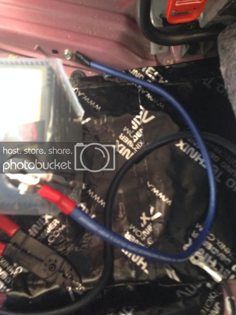

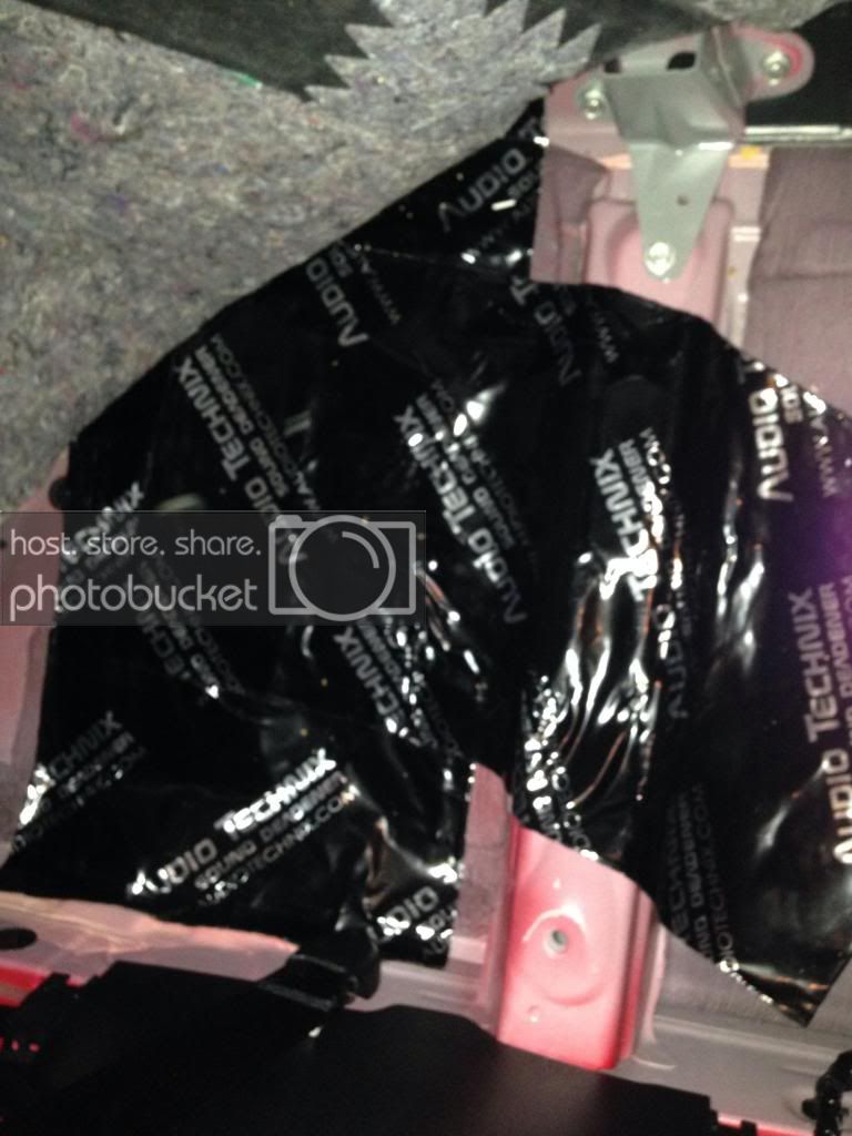

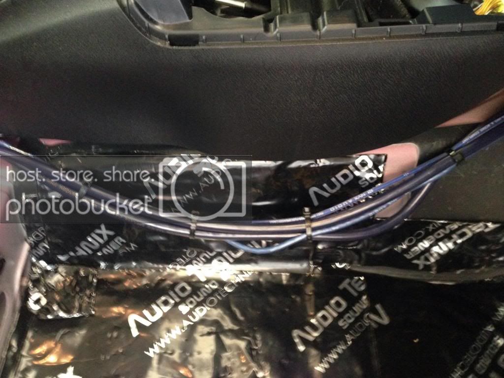

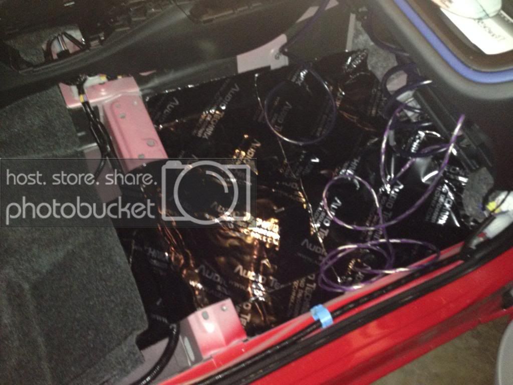

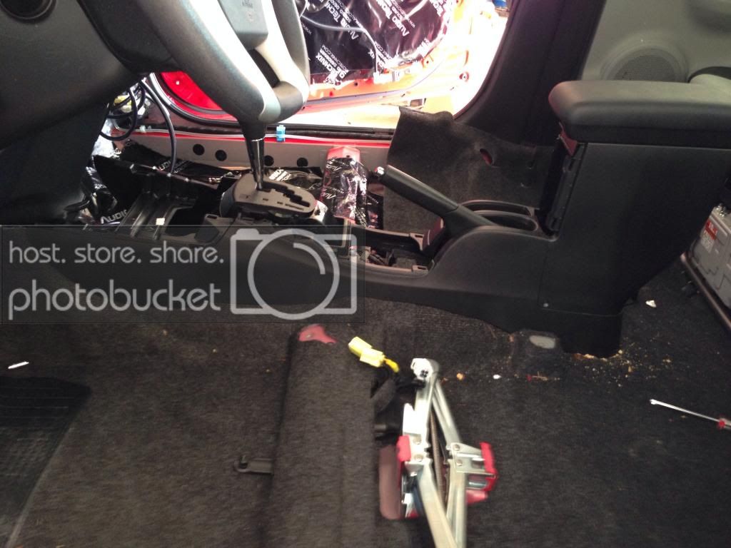

So I made pretty good progress on her today. Gutted the front cabin. Took out the front seats and the carpet which was fairly easy. Was hard for me because I could barely lift the seats. Keep in mind I had a discectomy less than 2 weeks ago. I shouldn't even be doing any of this right now, but I have the time and want it done. I applied 2 layers to the whole floor and 3 under the drivers floor and passenger front floor. Still need to do under the passenger seat.
I also got the mids mounted in the doors the wire ran. Was a huge pain the *** because the runner grommet for the wires going into the door is tiny and my wire is huge. It's about as thick as running a cheap 0 gauge. I had to redo the drivers door. I fucked up and forgot to zip tie the wire down to something to keep it out of the way and when I rolled the window down to check everything out it ripped it right out of the speaker. I was pissed, but it was my negligence.

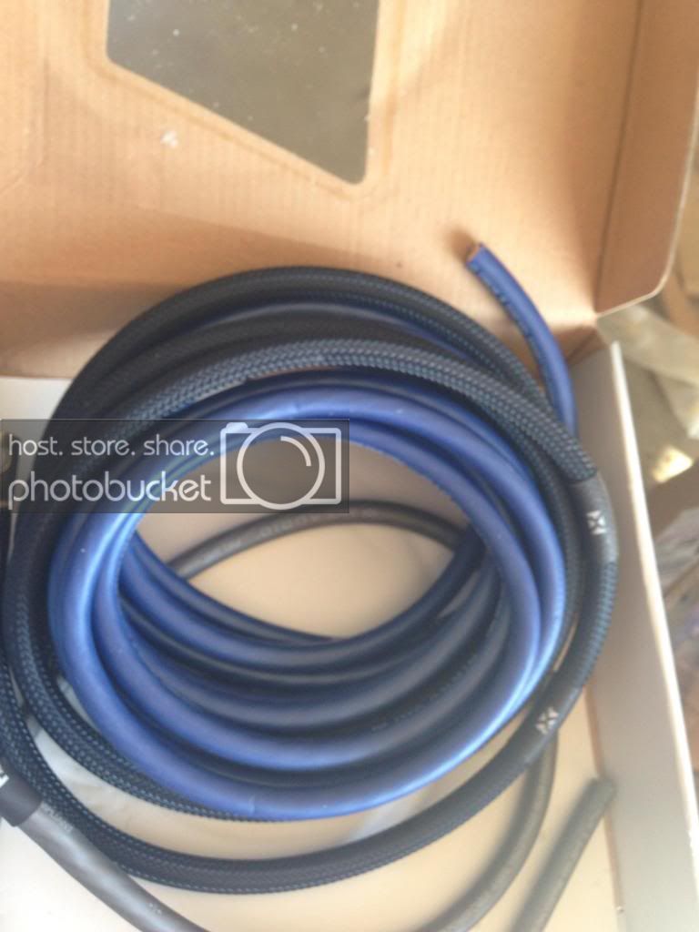

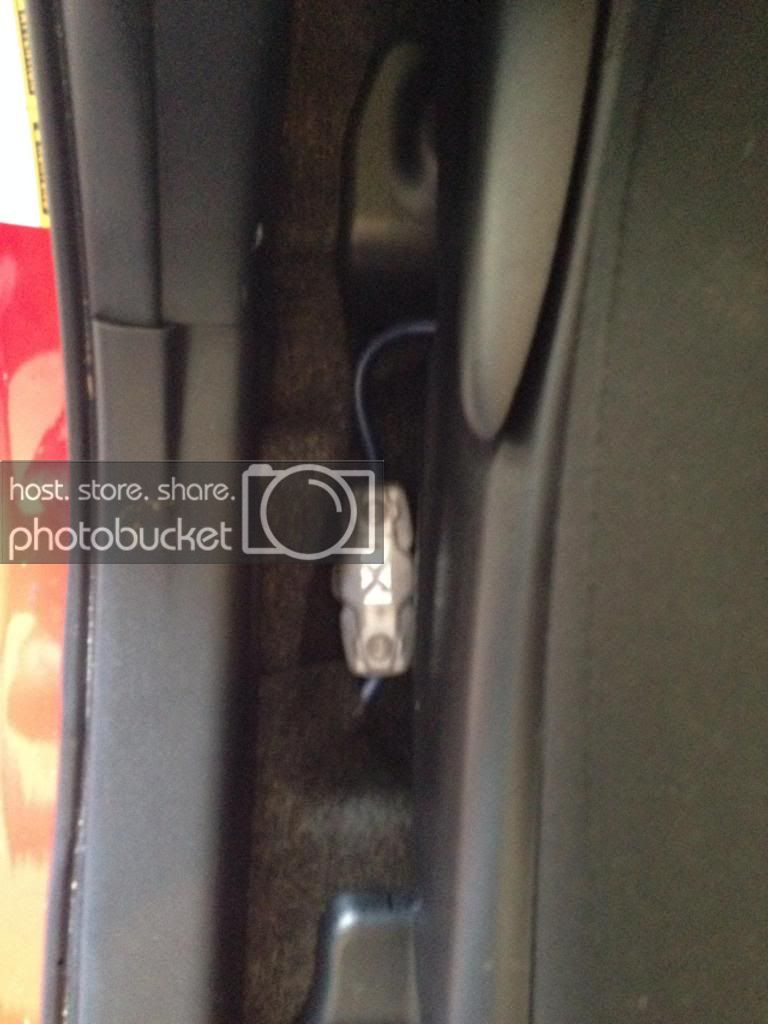

Going to be upgrading this tomorrow. It is like 12 gauge wire. Gonna run 0 gauge to it.

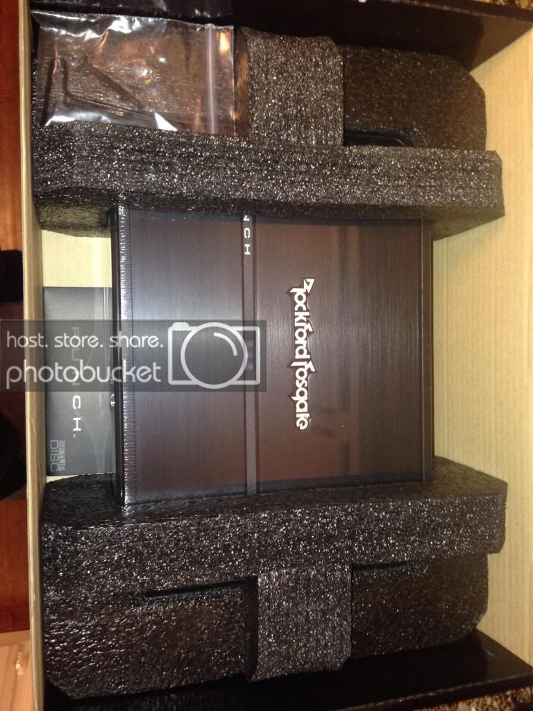

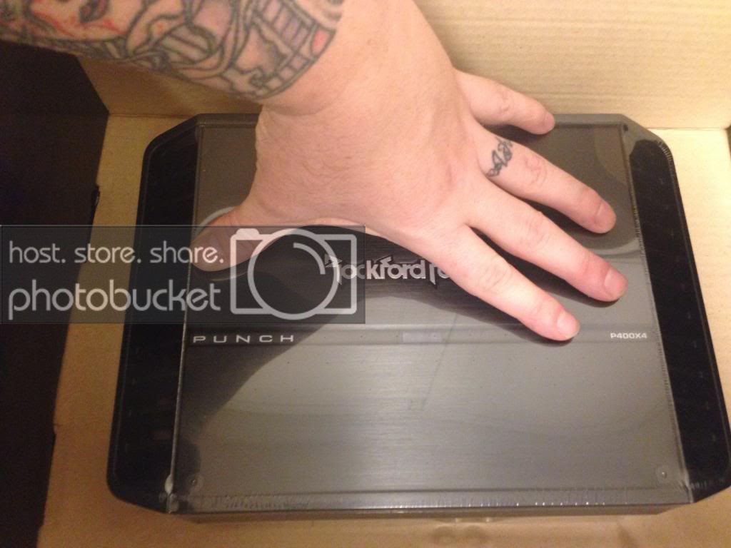

Look what came in tonight!!! My headunit, dash kit and amp kit were all supposed to come in tonight also but for some reason didn't. These thing is awesome. Very heavy for it size and typically RF fashion it is seriously under rated. It's only rated for 100 per channel at 2 but instead comes in at 150. This will be bridged to my Alpine SPX17PRO's and mounted under the passenger seat. This works perfect because there is an air duct that will blow right on it to keep it cool

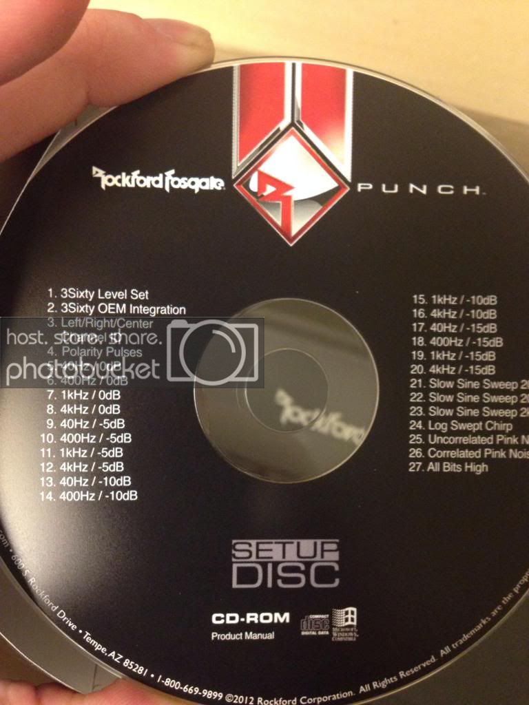

So I'm not 100% sure but I think this is to set the gains on it. The amp comes with both input and output clipping indicators. So it works great. I can get my max headunit output and amp output without having to borrow or buy an oscope. Will probably use one when at work one day anyways just to double check, but this will work for now
It's not as big as I thought it would be for being class AB and putting out the power it does

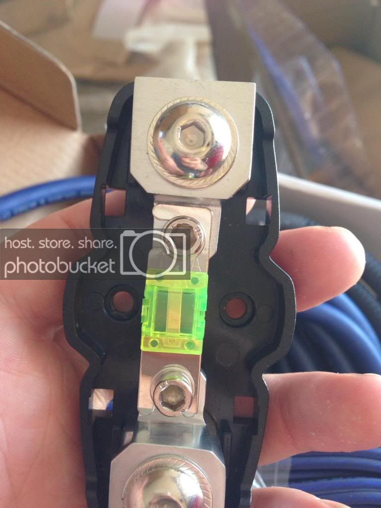

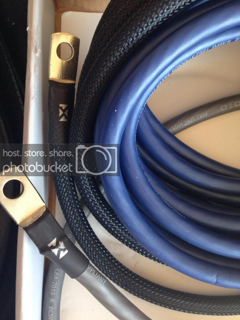

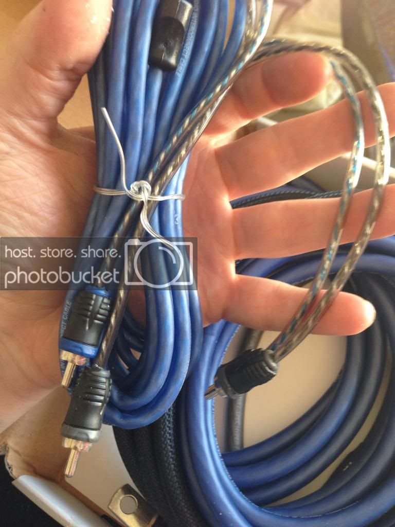

So yesterday I got in my headunit and wiring kit. I will start by saying that I am very impressed with the wiring kit. Great value for the price. Nice thick wire and I love that on the power wire they put tech flex on the area that would normally be in the engine bay. The ends are also heat shrunk. The speaker wire is nice and thick. It says 16 gauge but I had to use the 12 gauge setting on my site strippers. The power and ground are 4 gauge and is the same thickness as my knukonceptz 4 gauge. The fuse holder is nice and heavy as well. It comes with a 100 amp mini anl fuse.

I am LOVING the design on the Rockford 400x4. The Cd that you can use to set the gains is awesome. And I have the amp sitting now and could put on music and crank it till I get input clipping which is the headunit on 61 out of 62. Then turn my gains up till it turns blue and voila. I can switch between files and see the difference in the quality as one song may not clip and a certain gain level and the next might just a little. I will be doing a thorough review on it for sure.

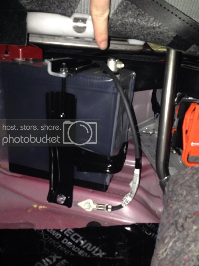

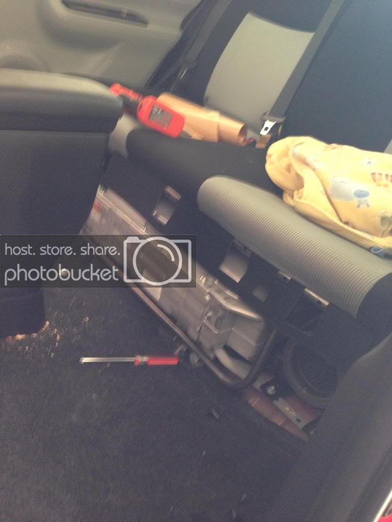

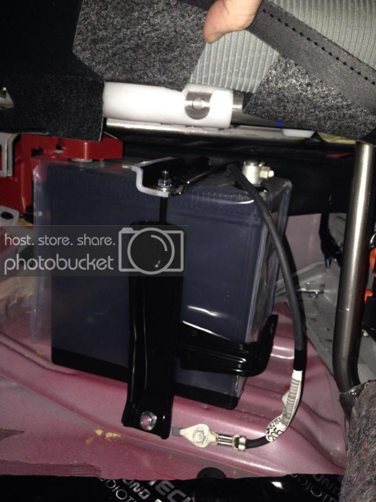

So I check the hybrid battery which is mounted under the rear seats next to the 12v bat and everything looks fine. So it was late and I didn't feel like messing with it last night so I put it off til this morning.

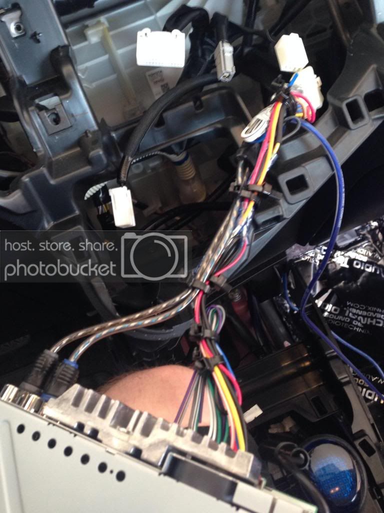

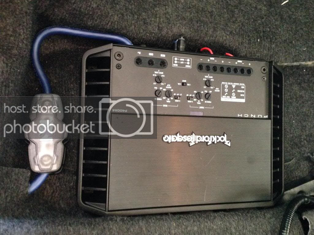

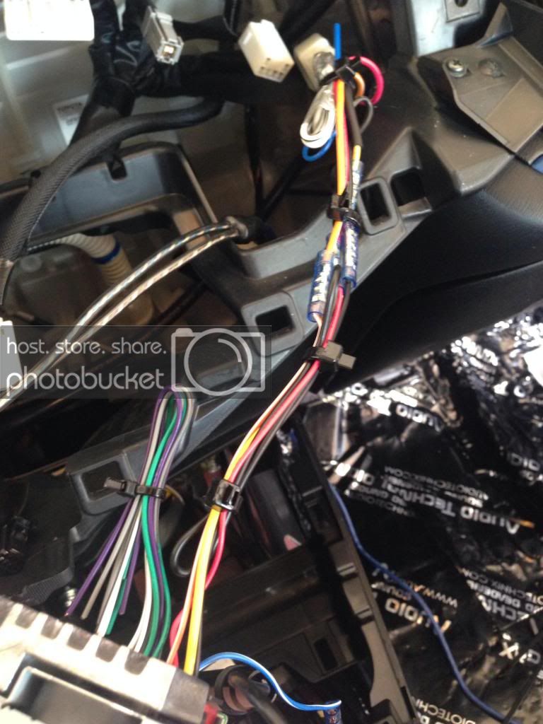

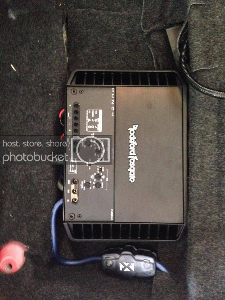

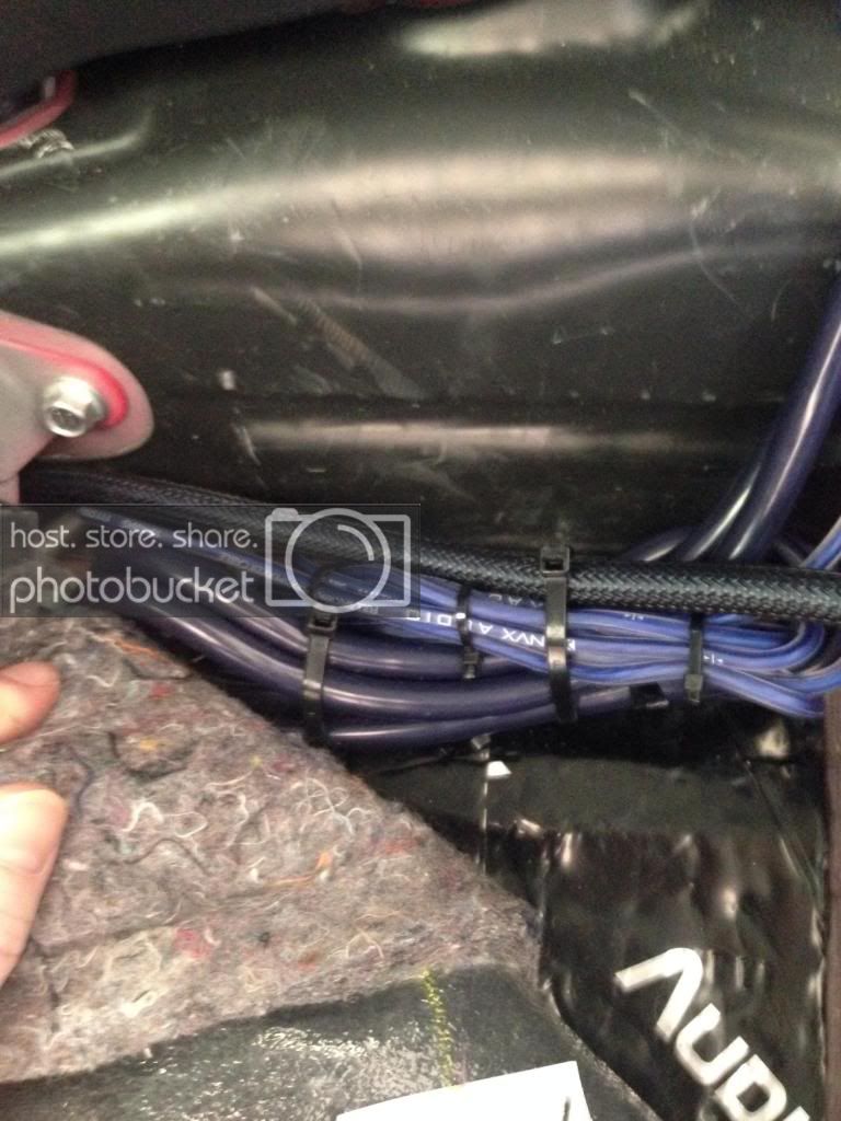

Did up the wiring harness. Used gold plated connectors for everything. Not cheap but work great. I didn't bother connecting any of the speaker wires since I'm using an amp. Everything was zip tied together every 3 inches or less. Used a lot more behind the dash to keep it all very clean. Hopefully I never have to undo it all.

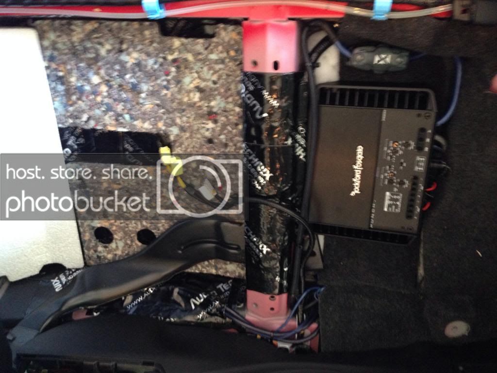

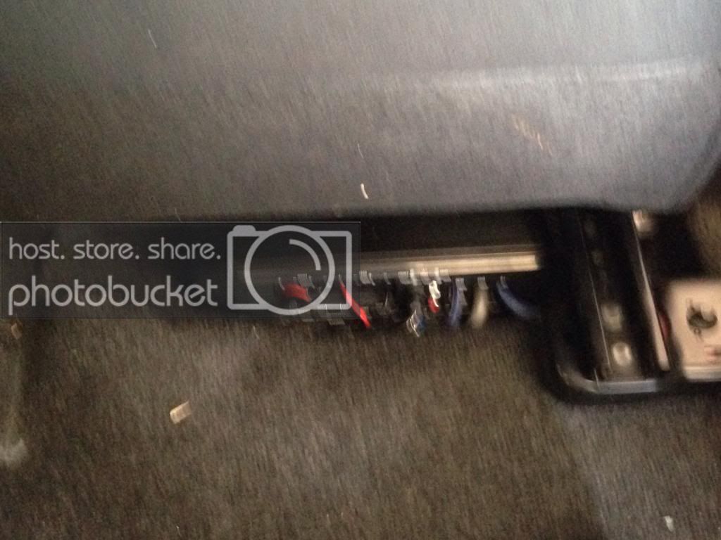

Here it is all finished. I placed the fuse holder where I did so that if it ever blows a fuse, I can easily access it and change it out. It is a perfect fit under the seat. Another cm of width and it wouldn't have fit. If you look to the top you can see where the air duct comes and blows right on it. Being in California I use my AC very frequently and never really have to use heat so it'll keep it nice and cool during the summer and my long drives
How it looks from the back seat with the seat all the forward. When it is in its normal position you can't even see it. I'll take a clearer photo later
