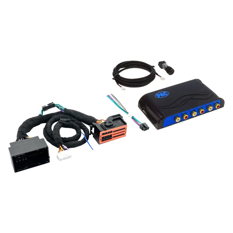

its the factory amp into line output convertor. Factory amps always mess up the signal with their built in EQ curves and crossovers. You arent getting a flat signal. The orion amp handles clipping better than taramps which is why you think it performs better. Taramps should perform way better with a proper full range flat signal.

Heres what I have. Im running the amp at full range with my old school PPI crossover set at 60 hz. This is in a 2018 Chrysler which means everything is set through the canbus signal. Does anyone know how to Sum the canbus signal to make the amp full range and eliminate the built in crossover?

i'm assuming its a chrysler 300?
