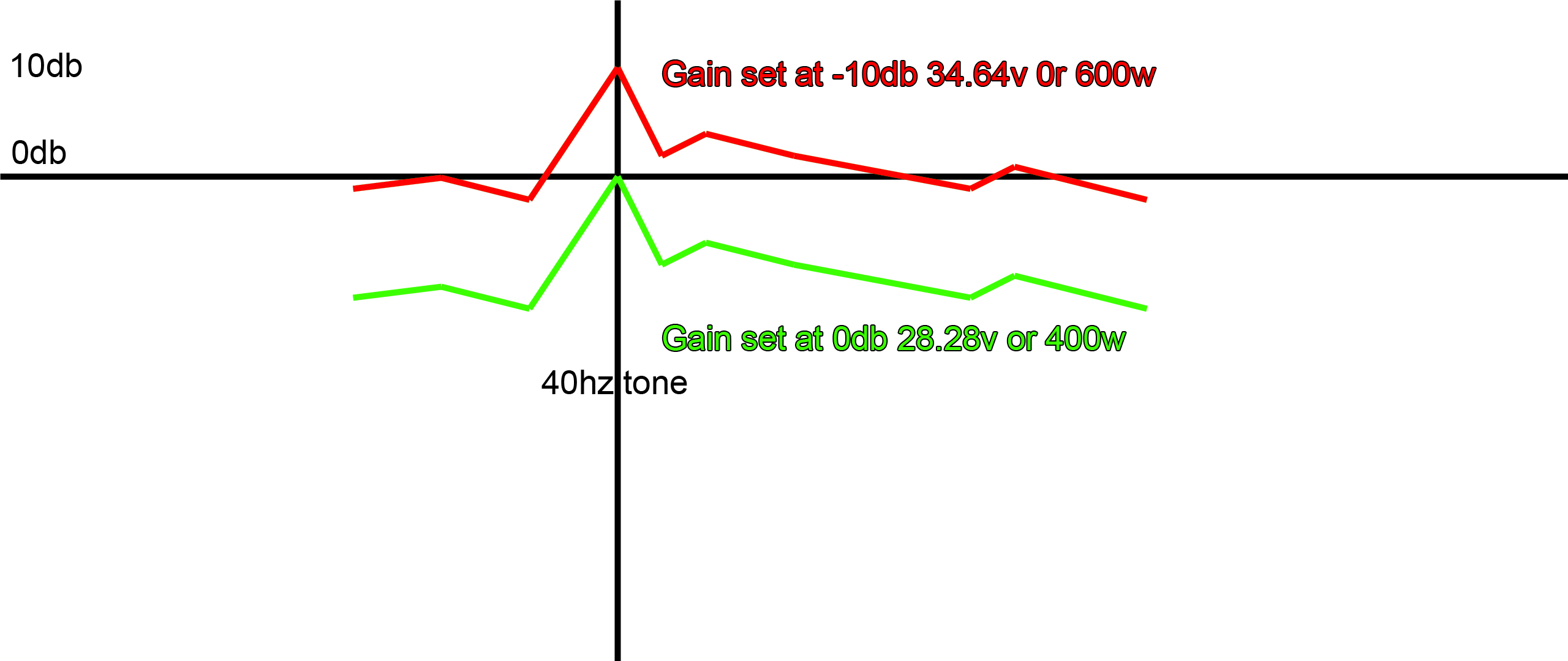

When set with the -10db tone, the subs peak can now be eq'd down and evened out but when needed the bass knob can be used to boost the sub. When using the 0db tone there is no room to boost anything and you are stuck at that output.
Also, 600w divided between the subs gives them 300w apiece on a tone. On music they MAY be getting 225-250w apiece. -10db tone setting allows for that little extra... which may let the subs see 275+ apiece briefly during different musical passages which will not blow them.

No, if he sets his gain on that amp for a 2ohm load to 400w with a 0db tone... when is he going to get 200w per sub with music? You and I both know he wont see 200w per sub. They will be underpowered on music with no room to boost them without really distorting them with stuff like a bass boost on the amp or loudness in the head unit.
My suggestion will get him much closer to 200w per sub with room to boost the signal with different, quieter music.
