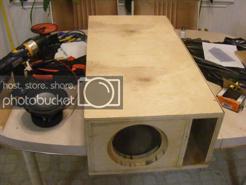

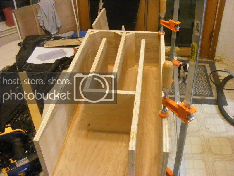

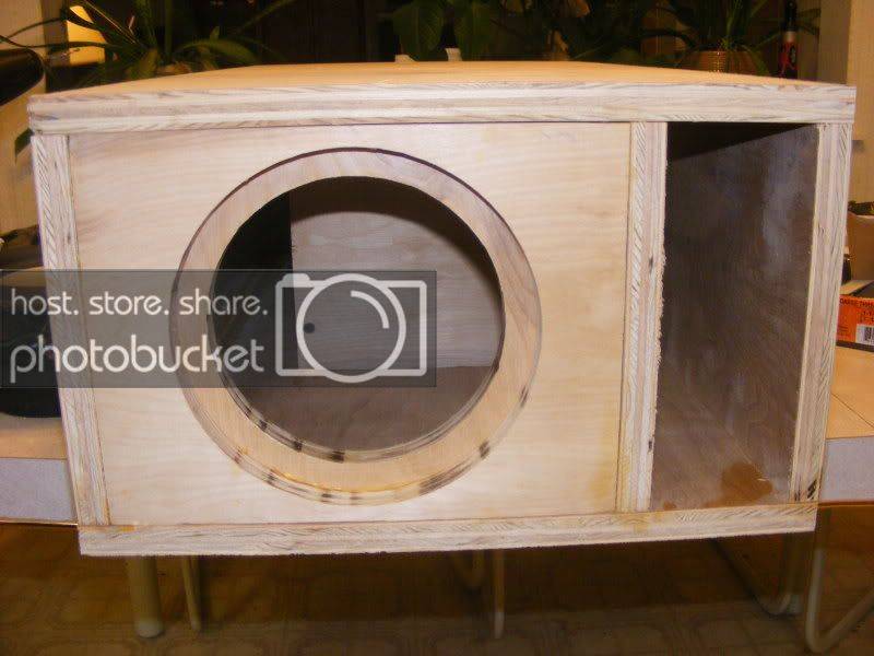

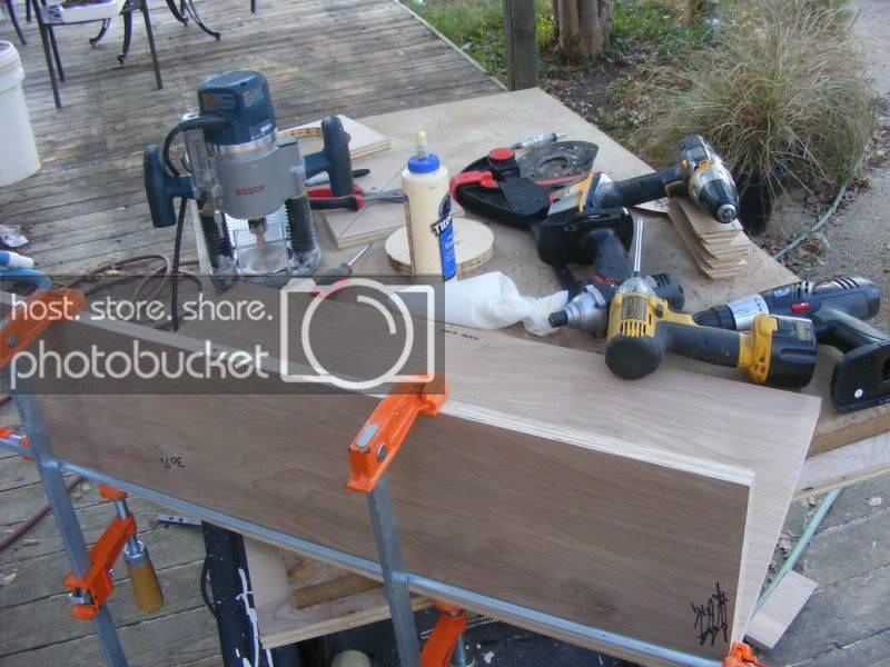

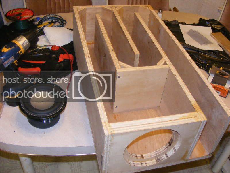

Heres a T line for Megalomaniac
Wood cut first side on
port in
port done with baffle in and 45s in the corners
top on and its done
Double flush baffle for the ed-700
Hooked it up in his car, was quite impressive for a little 6 1/2"
Because mdf cuts like butter and also much easier to route...just easier in general

I wouldnt call that a t-line really, meh...but I guess it is //content.invisioncic.com/y282845/emoticons/biggrin.gif.d71a5d36fcbab170f2364c9f2e3946cb.gif
Well, the only part that would make it not classify as a T-line would be the part directly behind the driver... but then again, that port doesn't look big enough to = cone area. =\
I could be wrong.
It is a t line, the chamber is because of the driver, blame ED //content.invisioncic.com/y282845/emoticons/biggrin.gif.d71a5d36fcbab170f2364c9f2e3946cb.gif
the line area is too small for the mounting of the driver, a compression chamber was needed.
