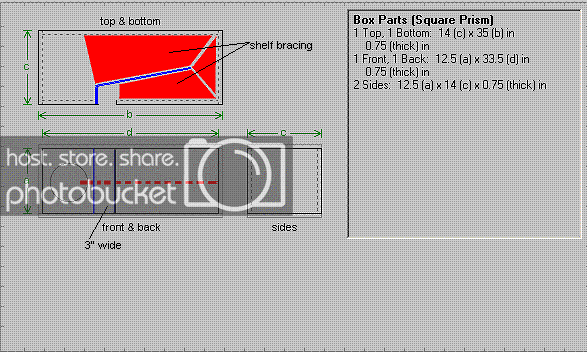

It is so much easier to kill a speaker in a tline and it also doesn't seem like an spl type enclosure, at least from the experience i've had with them. They are a good choice for home. I don't know much about designing them but this is how big i had to make a tline for my idmax, its a 12.
