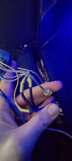

I disconnect the battery and install a new fuse...it blows as soon as I start the car. I check the wiring to my LOC and noticed I had a few wires with electrical tape, so I replaced them with shrink tube and replaced the fuse again.

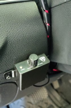

The bass remote doesn't power up

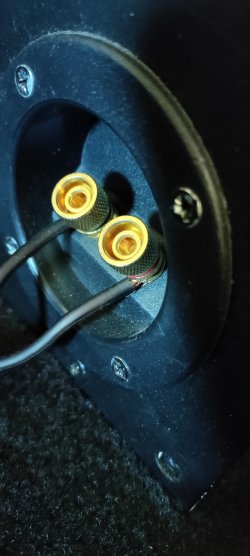

There is no signal from the sub

Well the amp still powers on just fine, however my bass remote stays off and the sub isn't getting any signal. There was only one time a replacement fuse immediately blew, but it hasn't happened since. I'm wondering if the LOC wires that were electrical taped may have been shorting out to the chassis somehow, because the amp powers on fine now that I went back and applied shrinktube to the taped wires, there's just no sound.

Just to make sure did you remove the bass knob and try? It will just see it at full volume, (you can at least make sure it's not the knob).

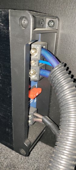

How is it all wired, specifically the power and ground cable ends. How and where they are wired, would be my starting point.
Pictures help the most, or describe in as much detail as possible.

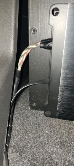

4a. Power/LOC on driver side
RCA/LOC/Bass remote on pax side

-All LOC wiring now has shrink tube
