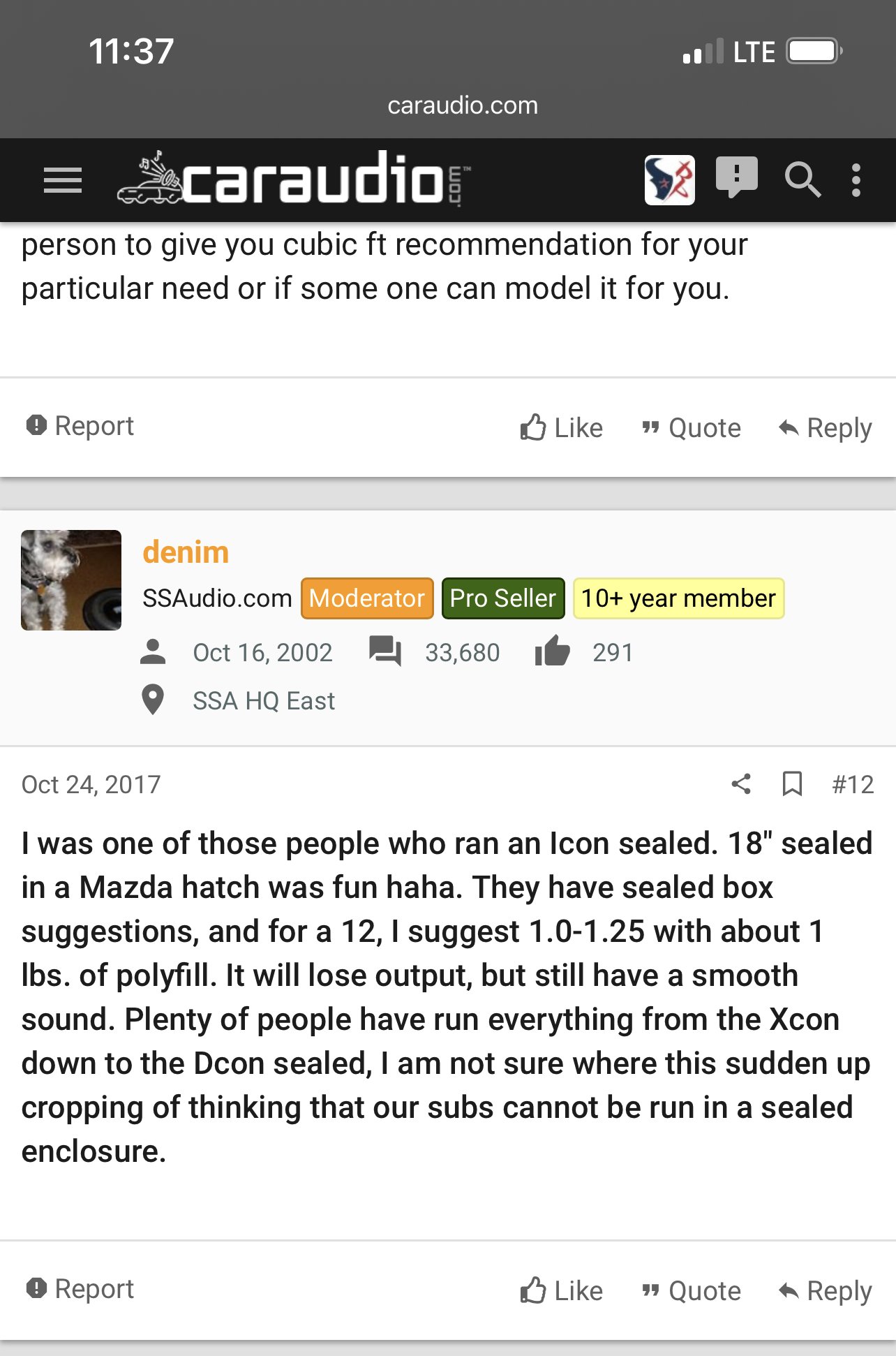

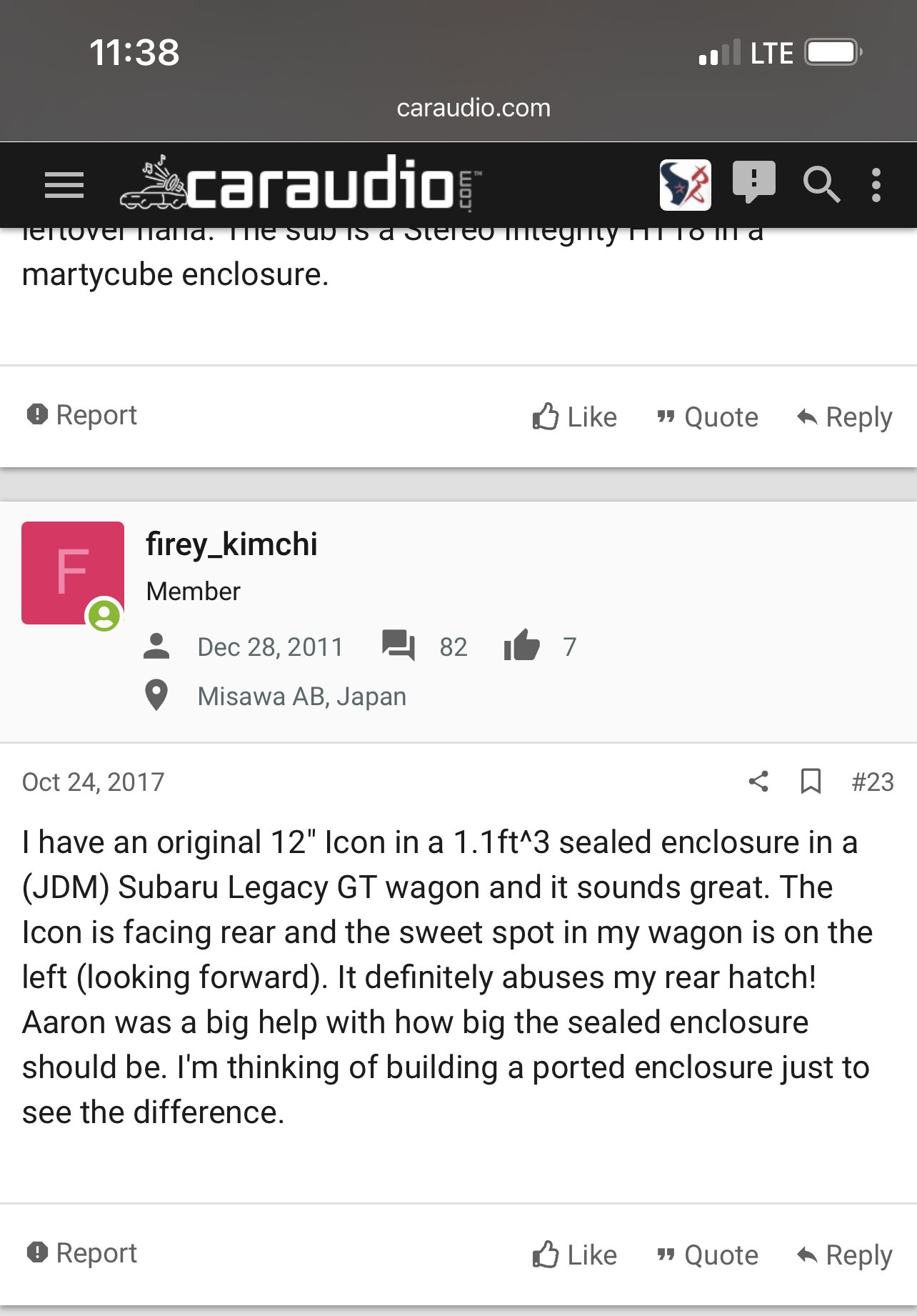

Here’s an old thread on here about running an ICON sealed. I’m really not trying to sell you on sealed (ported will sound good as well), I just think you should listen to some folks who actually run them sealed; and not to someone who says “do not go sealed” in all caps with no reasoning as to why not.
