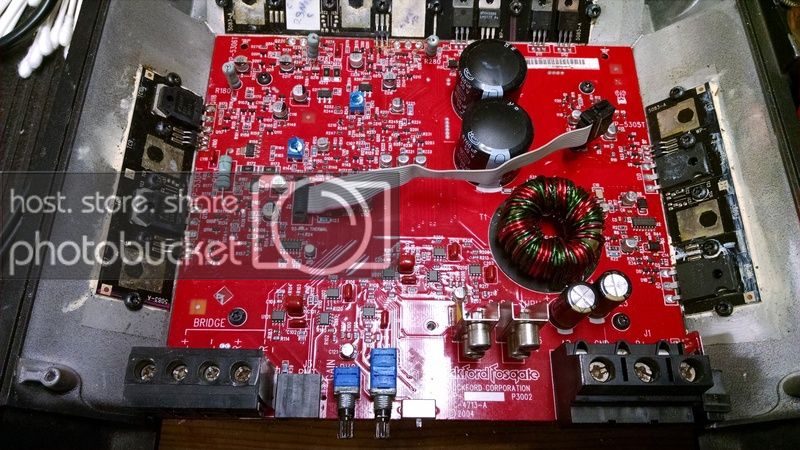

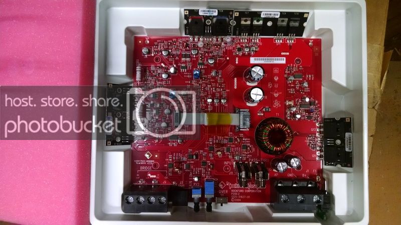

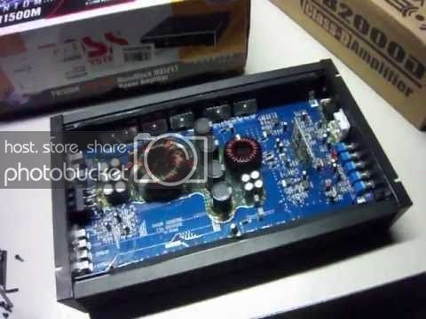

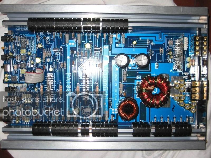

Just say NO to boss amps....let me show you something here .....
Here is a gut shot of a BOSS ph5000 amp ....claims to make 5000 watts ...ok ...

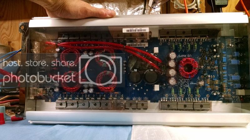

NOW, here is a gut shot of a US Amps MD3D, only claims to make 2000 watts ....
Which one do you think actually makes its rated power???
