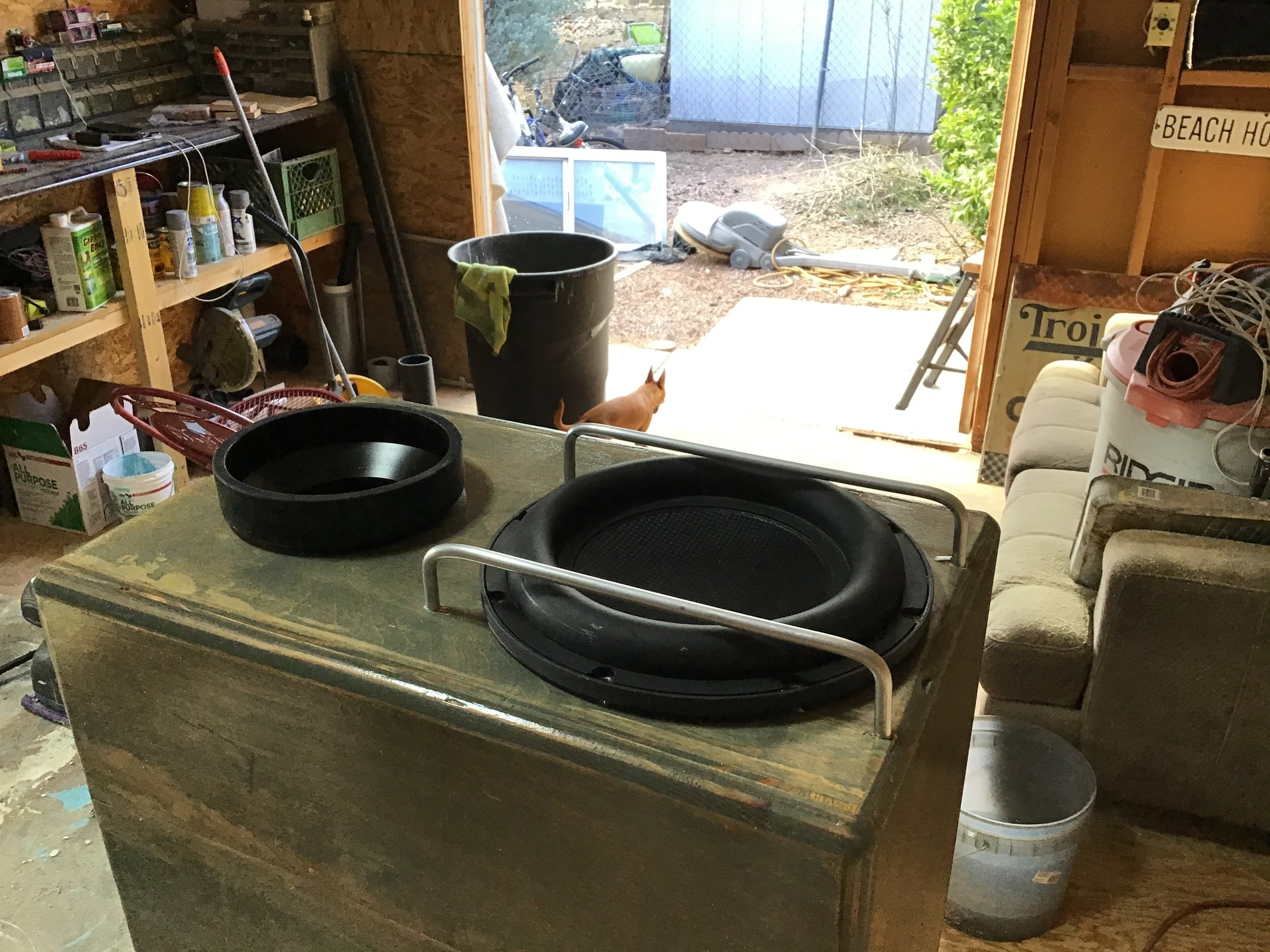

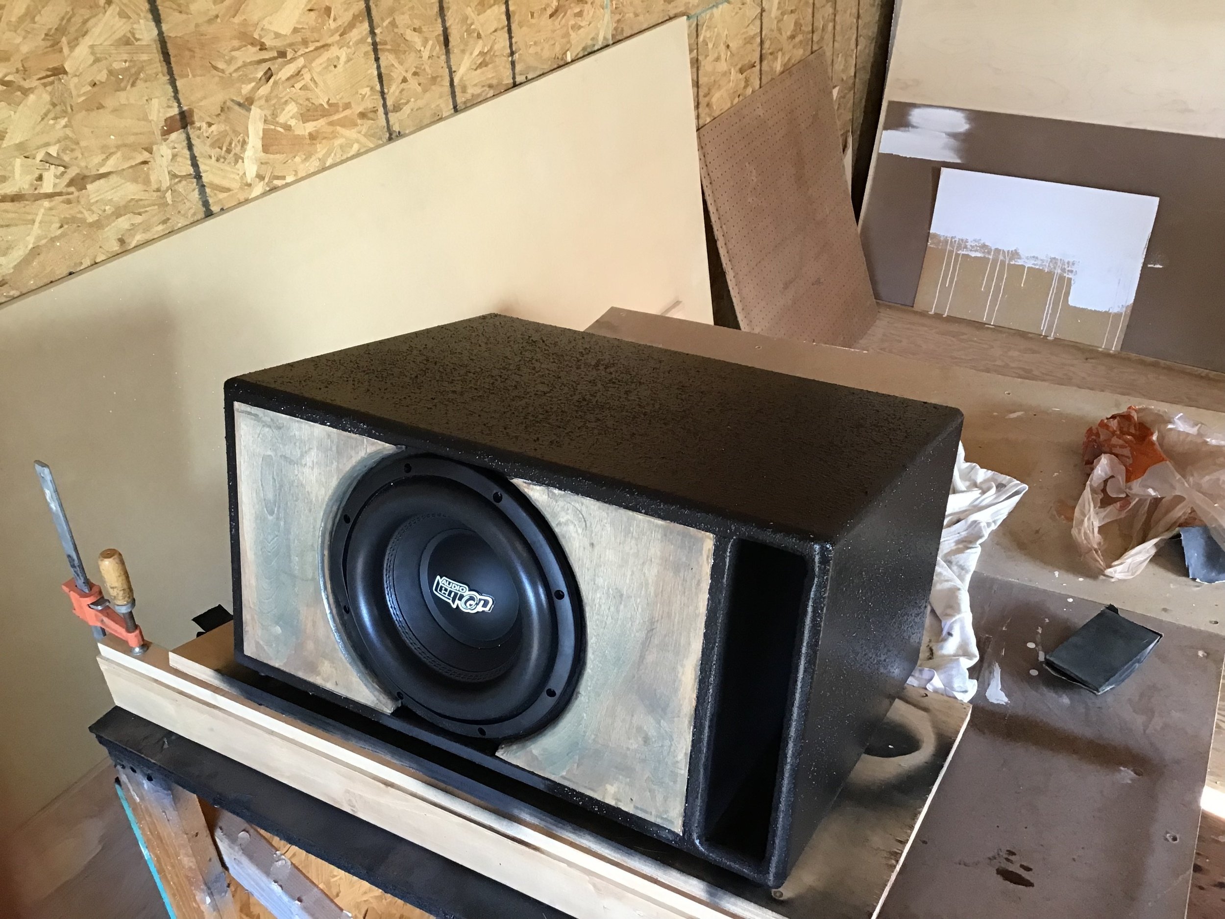

My amps have skeptical quality, I’ll give you that, but there’s nothing hugely wrong with my build. I just pushed too much power to a sub technically meant to be sealed. It happens. It was in 1 cube tuned to 30 hz. The other sub is an Audio Legion 10 I had in the closet. It doesn’t sound as good, but it’s louder and will do until I get something better.
View attachment 31043View attachment 31044View attachment 31045
That 8 looks like it has too much port which could easily cause unloading issues. The 10 looks fine and like you said was probably just overpowered.
