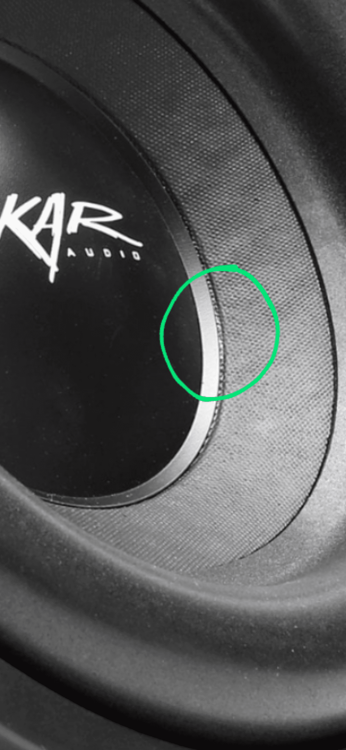

Go along the perimeter pulling on the edges of the dust cap. I've had this happen a few times, and just as described, it was noticable on kickdrum and sharp bass notes. I use black speaker suspension glue, it works great and easy to pick at the excess once cured.
So essentially remove the dust cap then glue it back on?
That would be the best option. Sometimes the rest of the dustcap is glued well, and pulling it may damage the cone. In that case it is best to just glue the loose portion. I would put a paper over the loose edge and stencil the dustcap. Then trace and cut out masking tape to protect the cone from excess glue.
This is only after ascertaining that there is in fact, a loose dustcap.

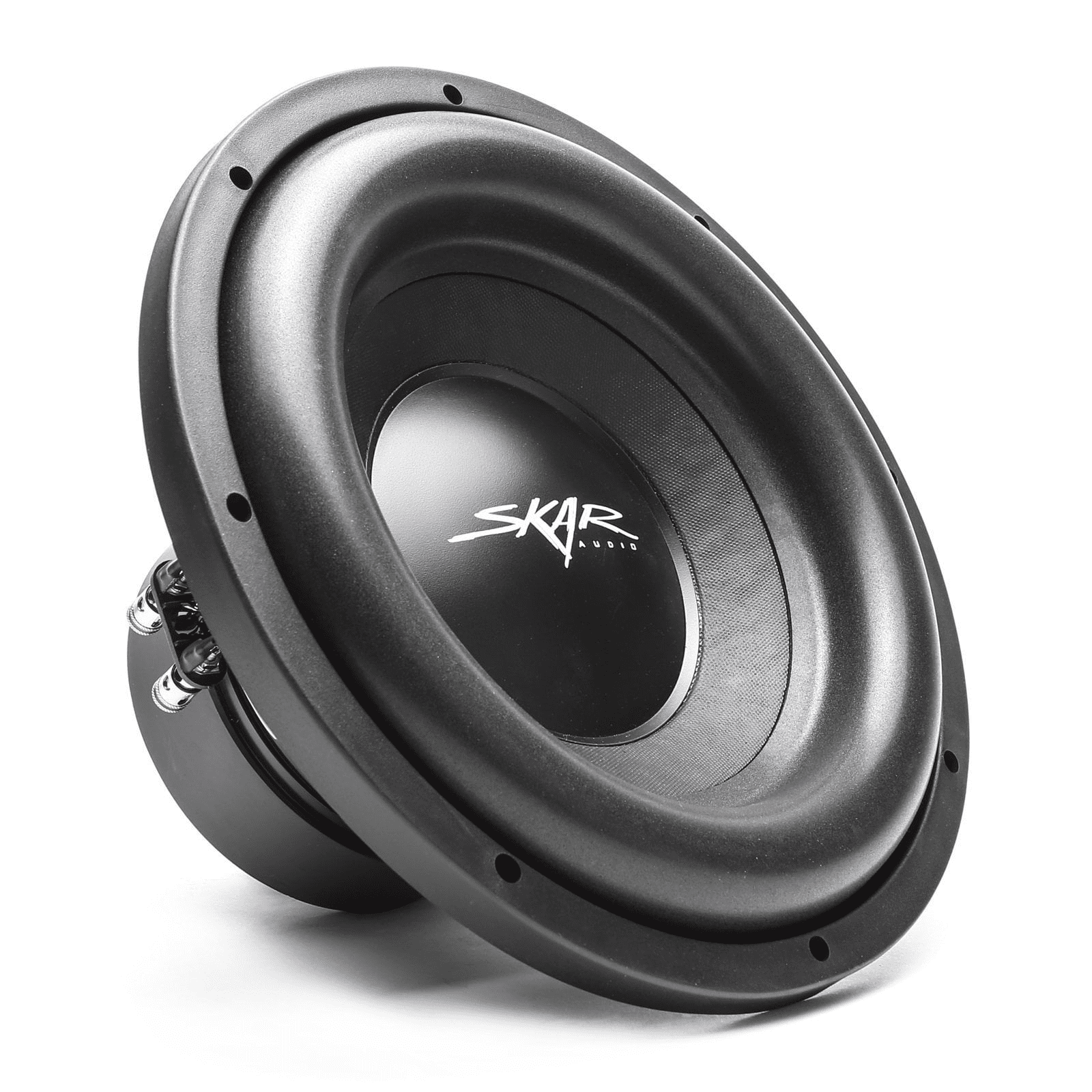

on my enclosure there's a plastic ring screwed into the edges, should i remove that to check, definitely a newbie, sorry for the questions haha
Glad to help where I can. The dust cap is the dome in the center of a subwoofer. Some are a dome while others are concave. Some are the size of the entire cone. Unless it has a grille, there is no need to remove the outer trim. Would you post a picture of the sub?
