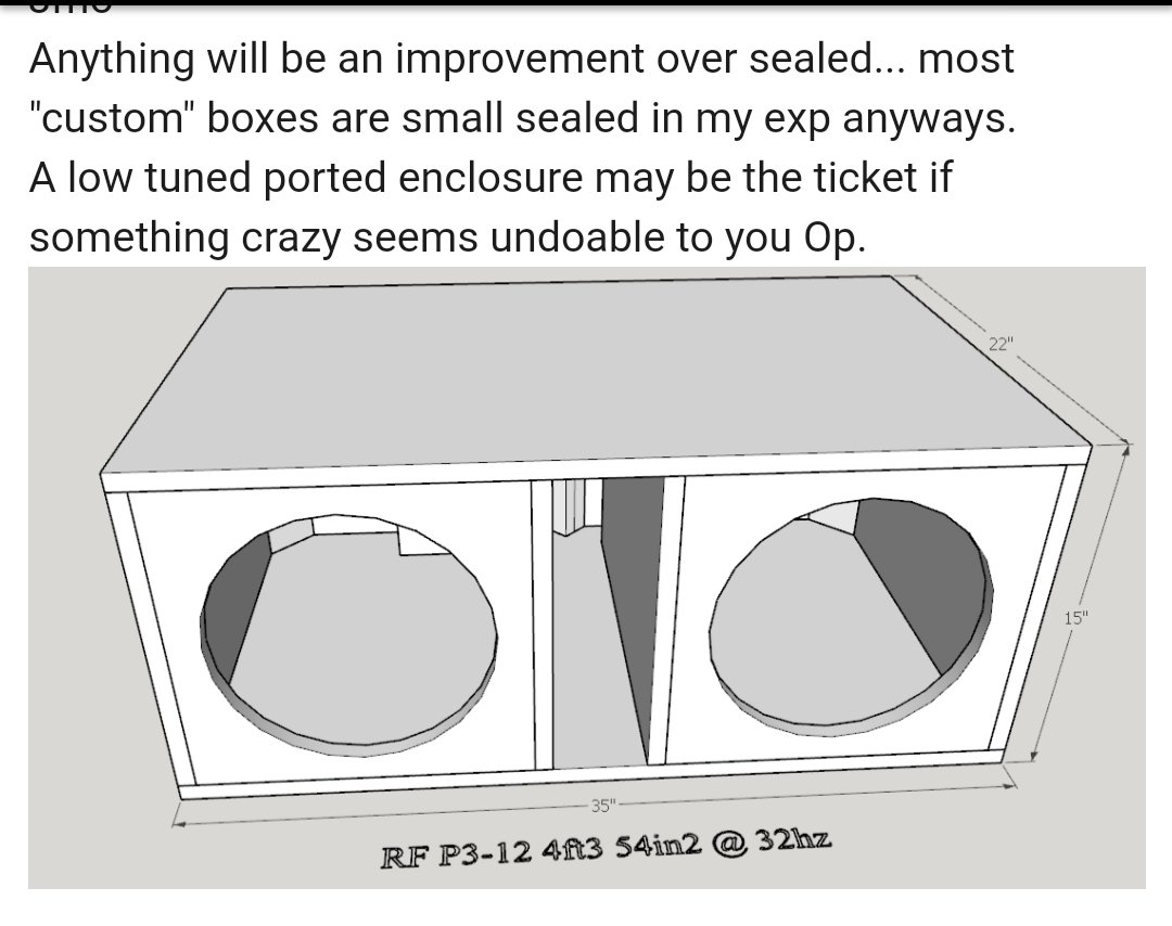

Anything will be an improvement over sealed... most "custom" boxes are small sealed in my exp anyways.
A low tuned ported enclosure may be the ticket if something crazy seems undoable to you Op.
P3's are versatile, but in small sealed they lack lows imo.

Well damn. Rockfords site lists them as preferring sealed enclosures, so I had a sealed box built to rockfords recommended specs at 1.02 per sub.
Why would they recommend such a small sealed enclosure?
Probably the top reason would be marketing if I had to guess. To the average 1st time user space considerations have to be one of the top considerations when buying.
Put em' in a ported enclosure designed right and they'll come alive. Make better use of your power and have some great lows. On that amp you've got 4ft3net tuned mid-low 30's is what most people like.
If you'd like to try ported and are in build mode on another anyways message me. That ported I put up there above is actually a nice fit I just noticed. I can forward the plans to you to try out. Its a simple build actually and will gain a bunch, especially down low.
