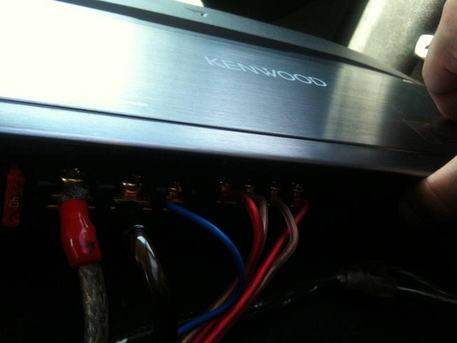

The way my subwoofers are wired now. Each the same...
Some fosgate wiring.
The wiring on the amp. By the way, for some reason the fan was not turning on, could be the reason the amp was getting so hot within 20m of cp.
Further testing required. Perhaps one of the wires were loose. I can't remember hearing the fan going since the new install. I fixed it though.
Subwoofers are not connected together by any wire inside. They are connected separately.. and lead to the amp l/r l/r as shown in the photo above.
