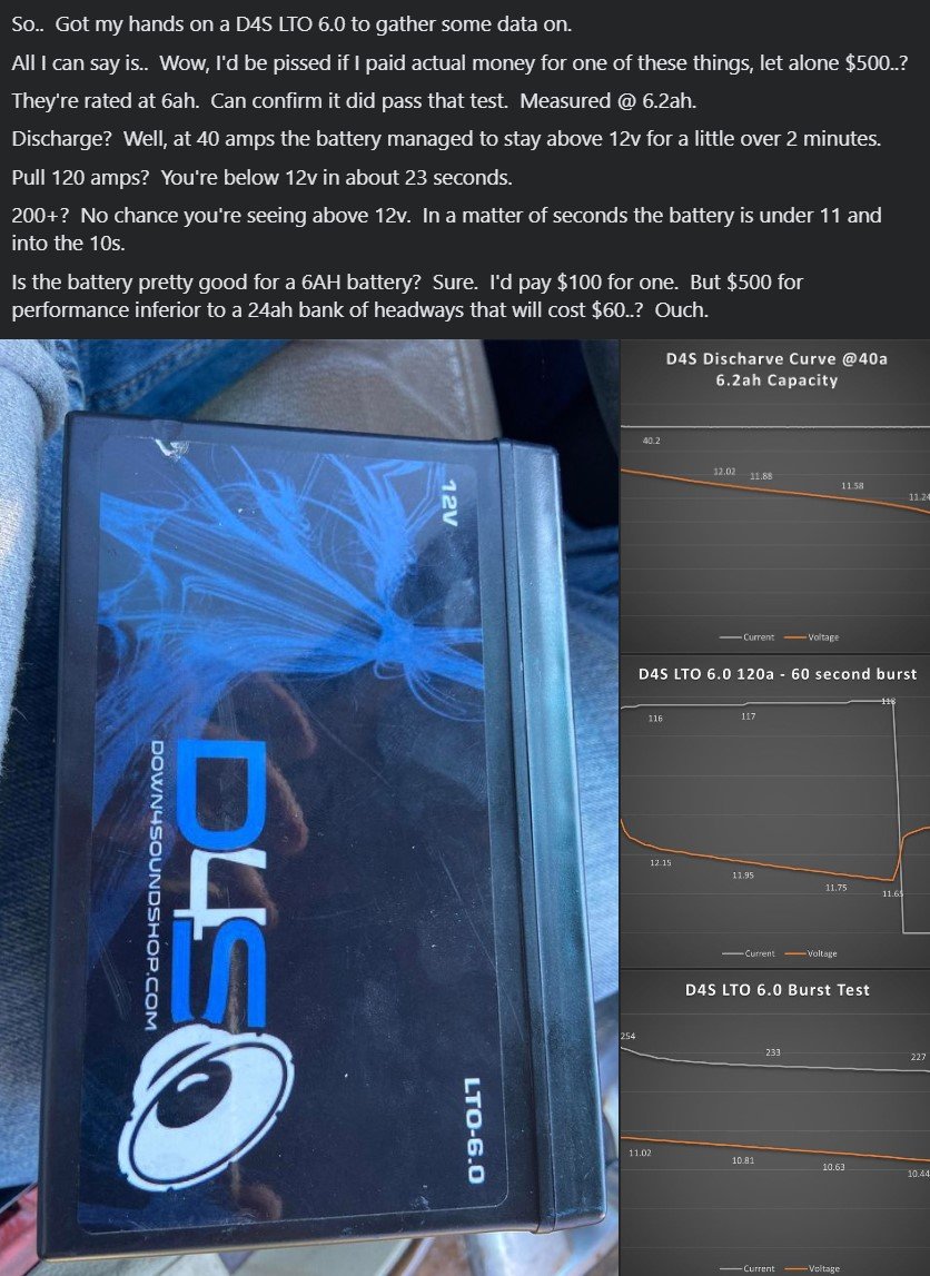

I mean...any decent LTO will do. Just be sure to get something that charges in the right voltage range and you'll be (y)
Yea that wasn't a decent lto. They are 5s lto and fail when charged above 14v they also have next to no capacity. I get they were one of the first to come out so ignorance plays a part but that d4s 6.0lto is one of if not the worst car audio targeted options available.
