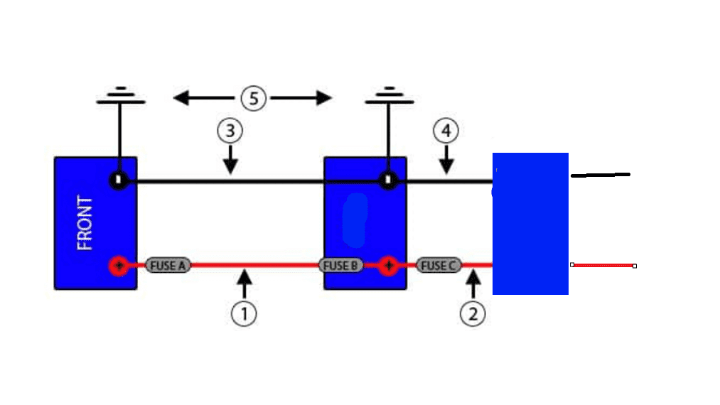

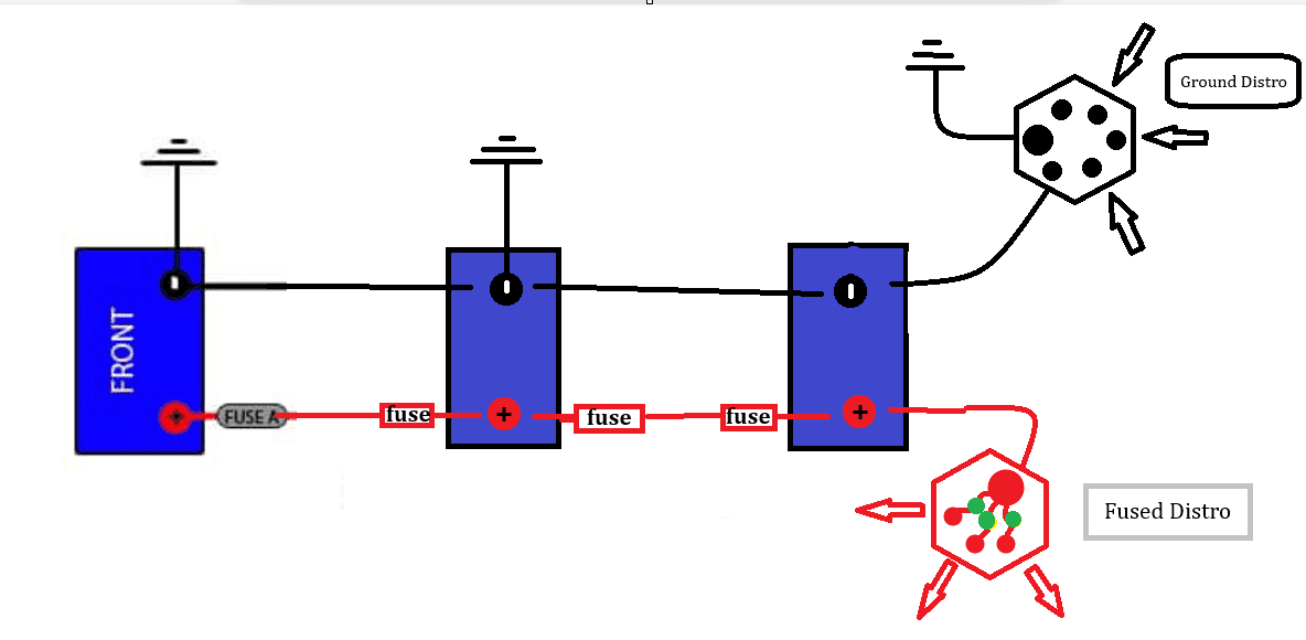

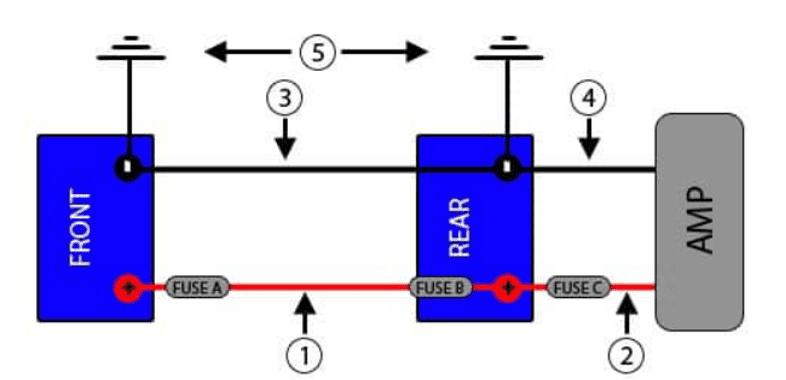

It's not all about the potential amperage draw; it's more about real-world, daily driver draw on steroids, if you will. Watch this video on what to expect, and then see if you think that Limitless is going to serve your needs.
It's not a difficult upgrade, and I have wiring diagrams to boot.
This is the basic idea, I'd be happy to draw one up specific to your needs.

Okay, thank you for the information I'll use this when I get to setting up my system. I have an auxiliary battery in the front and my main battery is already trunk so I should just wire the extra to the main right ? Should I upgrade the other to batteries or no?
Okay, no worries.
You would run it in parallel with the 2nd battery.

Okay are the wires on the right of the third batteries for ground. And power to the amp or both run to amp ? Thank you for the information also should I do the big 3 or should I be fine ?
Do your installation. Get a voltage display. A small LCD type display. See what your voltage is like. If it starts going into the 12v range then you want to start beefing up your electrical.
As Doxquzme has said, you might be surprised how well your system does on a relatively stock setup.
