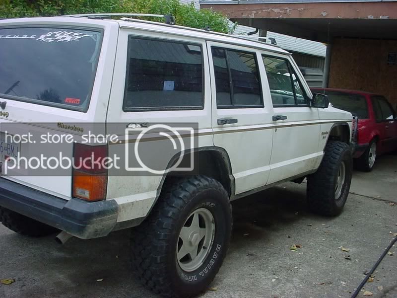

The 33's fit OK in there, but rub in the rear. The lift is actually a little less than 4"s also, probably about 3.75".
I've got about 6.5-7"s of uptravel all the way around. The fenders are trimmed quite a bit though. Heres a pic that shows the trim.
