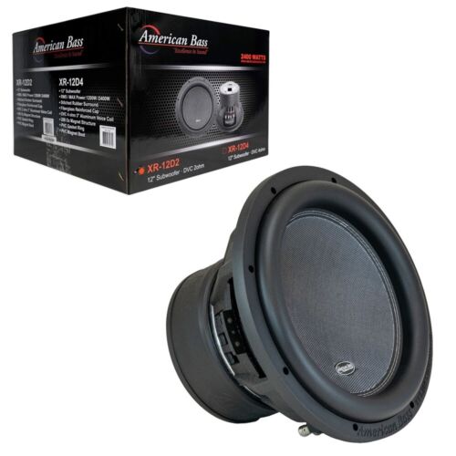

As for upping your game for around $350.00, these are close at $398 a pair.
Or even better yet, from AB at $370 a pair:
I'll take those NVX over the AB any day. I have run the NVX they will take a beating and sound good doing it. I lost all faith in AB.
Yeah, I'm a fan, have not used AB in a long time. Have never had any issues with the NVX product. Their shiping packaging leaves something to be desired but the price to value ratio, the customer service and the products are top notch.
