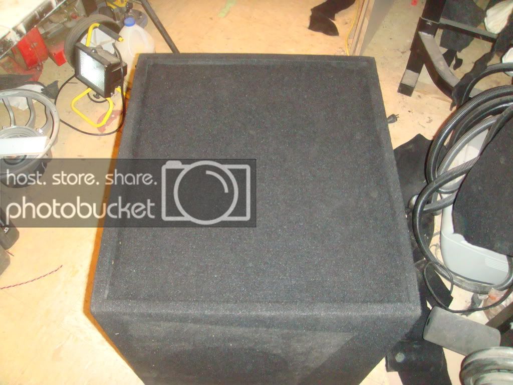

Fiercetimbo17 10+ year member CarAudio.com Veteran 2,401 0 dallas Feb 17, 2009 #19 Did you end up datoing the top? Either way it looks great. Also on the recessed sides if you rabbet them it makes carpeting a ton easier and only take a few seconds if you have a router table.
OP Mike465 10+ year member Ami Creations 2,858 6 Kennesaw, GA Feb 17, 2009 Thread Starter #20 Did you end up datoing the top? Either way it looks great. Also on the recessed sides if you rabbet them it makes carpeting a ton easier and only take a few seconds if you have a router table. Click to expand... Na I didn't dato the top. Thanks for the pointer on the carpeting on the sides I will have to try that.
Fiercetimbo17 10+ year member CarAudio.com Veteran 2,401 0 dallas Feb 17, 2009 #21 I do a 1/8 by 1/8 rabbet all the way around.
OP Mike465 10+ year member Ami Creations 2,858 6 Kennesaw, GA Feb 17, 2009 Thread Starter #22 Does it make a very noticeable seam?
