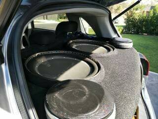

I am still running old school American audio in my current ride.   Boston pro 6.4s, Rockford coax - PPI Power Class PC450, speaker amp, Phoenix Gold RX1100.1 mono running a pair of Boston 12.5LF old school subwoofers in infinite baffle, they sound amazing!!
BTW, that is not my car mate!.  I have listed my car here on the website,  If you look at my profile you will see Mitsubishi ASX and I have some install pics of it.
Hope you are enjoying your current sound system in your ride.

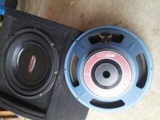

Attached is the pic of my current ride.  I have since changed the Rocford P215S4 subwoofers to Boston Acoustics 12.5LF.  I have a pair of old school Soundstream Rubicon 12.s that I may give them a run as well.  So far the Boston's are just impressing me everyday. They have more punch than the RF subwoofers.
