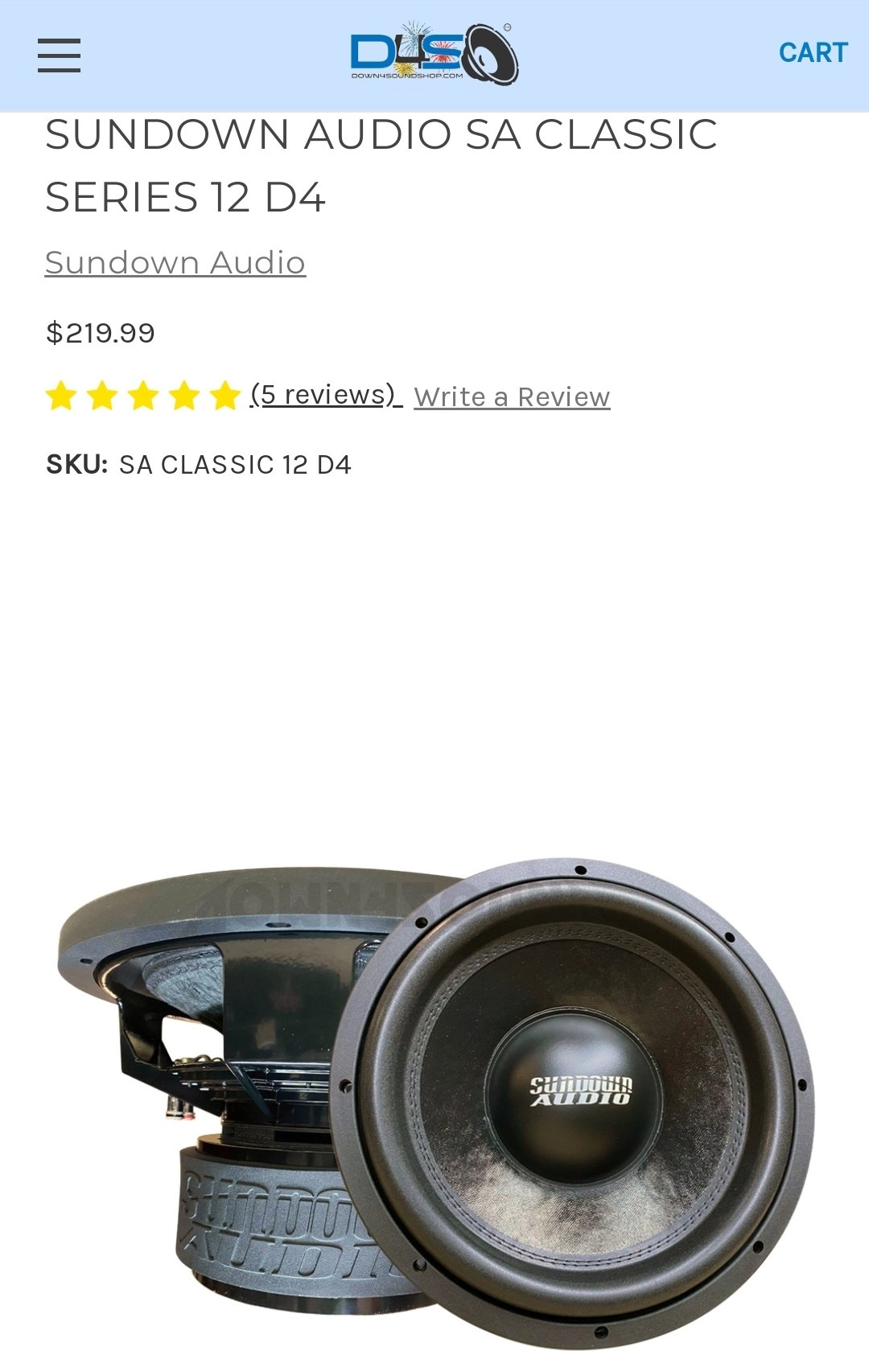

Two of these in a ported box. Subs up and port back. You can still run the Apex Cab-22 amp. The box should be about 3.5-4.0 cubes net tuned to about 33hz. should really get down.
