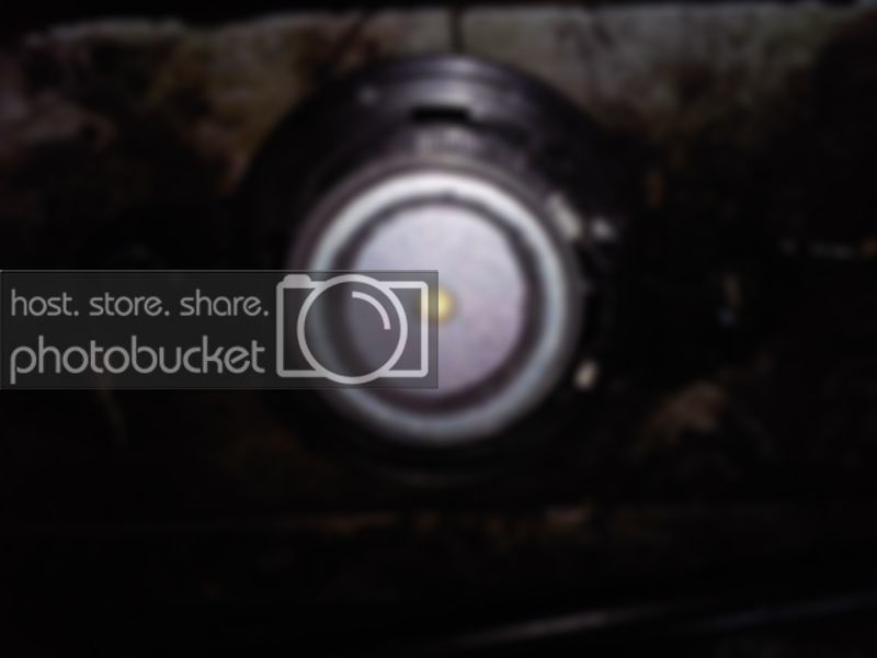

Decided to look at the dash tweeters and I was expecting them to be dome tweeters given the good sound, but they are cone tweeters.
I promptly installed a couple Onkyo dome tweeters I had gotten from a box of 200 I purchased on Parts Express a few years ago for $10.
Whoever designed those original tweeters made it easy as I just had to loosen the ring at the rear and desolder two terminals then solder the dome tweeter wires along with a 12 ohm resistor in parallel to keep the impedance at 4 ohms.

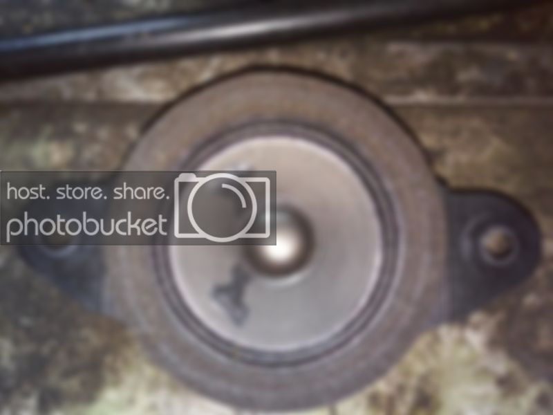

Here's the mount I made for the tweeters
Here's the tweeters installed
That just lowers the impedance to the 4 ohms of the original tweeters.
Also the 6 ohm impedance of the tweeters would have lowered the crossover point by almost 3KHz and I didn't have the right capacitor value to replace the original with.
Only temporary though and they sound balanced with the door speakers.

Here's the original tweeters.
