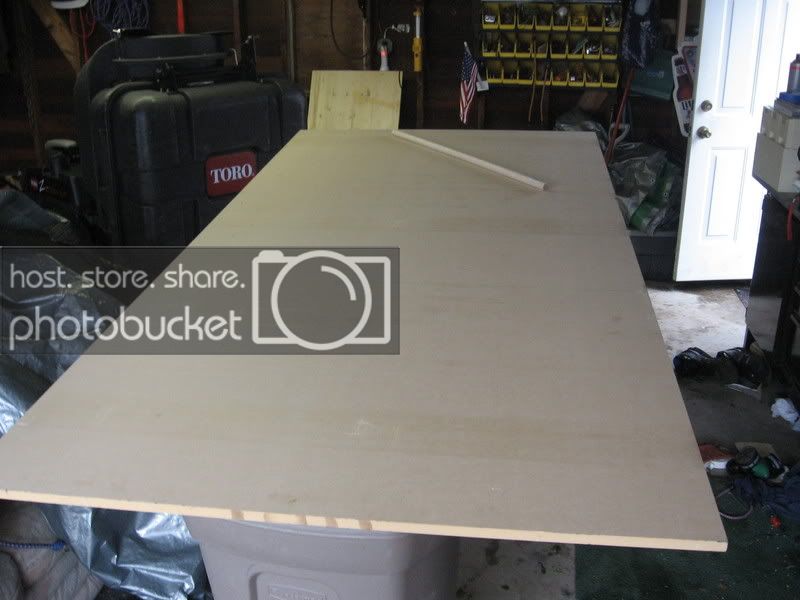

Well guy's just thought id give you a bit of an update im going to probably starting the build sometime next week will buy the MDF , Dowells and start the build i will be sure to take pic's:).any other suggestion's or comment's before i start the build or tips would appericate them.
