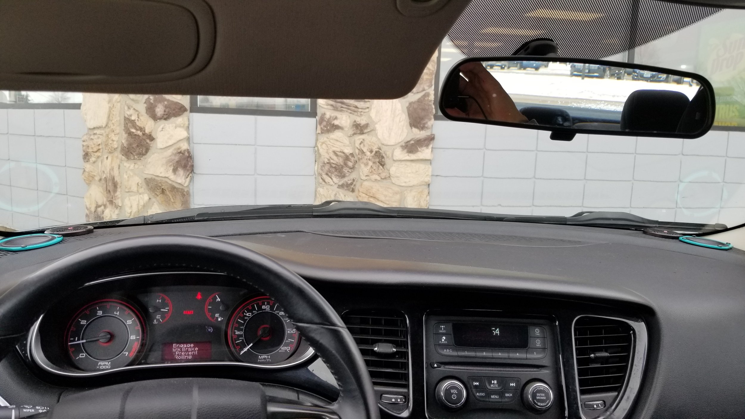

Leave the center speaker alone for now, if it even comes equipped in the package you ordered. The stock front speaker locations are fantastic. My 2013 Dart uses them in a sound quality build. I have 4" mids and 1" tweeters mounted into the left and right dash speaker cover.
Use the Infinity amplifiers. I recommend Audiofrog GB60, GB25 and GB10 for your main speakers. The tweeters can fit in the dash right next to the 2.5"s.

This is the dash speaker layout I made for my Dart. Tweeters touching the mids, tucked far against the corner of the dash and windshield junction. The Audiofrog GB25s and GB10s are dead simple to mount into a panel.
