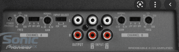

tell me, whats normally the range allowed in a HPF set on an amp?
I got my hpf set around 200hz on my components up front and about 100hz on my rear doors...that's what works with what I'm running...but every system going to be set to what sounds right to the equipment and car...no two will be exactly the same...
i have the below amp
40699
its powering 4 pioneer speaker model 1675v2 which runs within 35 Hz to 20 kHz. ive set HPF on the amp. so, where should i set the frequency knob?
