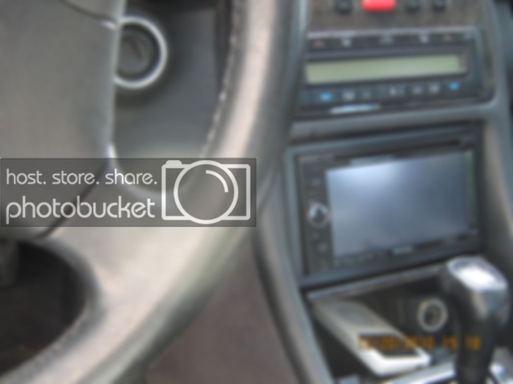

how did u bypass the factory amp
Its hooked up temporary now...I cut up some RCAs and tied the ends into the factory speaker leads to give the factory BOSE amp low level inputs ...then just connected the remote to the deck...the benz uses the same remote wire colors as the deck...blue with white stripe....the stock BOSE speakers are about half blown...I'm gonna do an update on them soon when I add an aftermarket amp....
