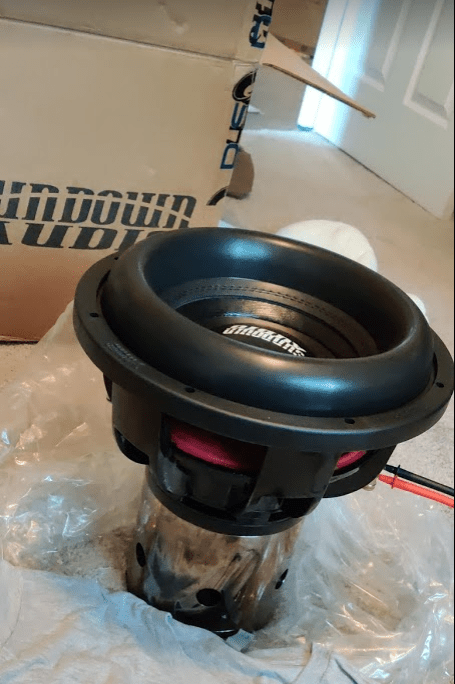

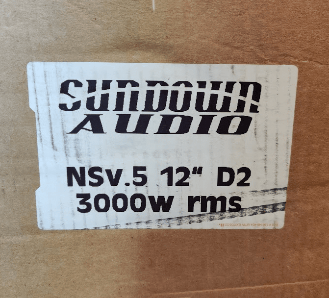

You gotta have super clean power. I know dudes who use the hell out of the v4's, they're 18's. He had each on 8k and the sub was bottoming out but he literally couldn't blow the coil. LITERALLY. These subs are absolute MONSTERS. Great choice bro.
