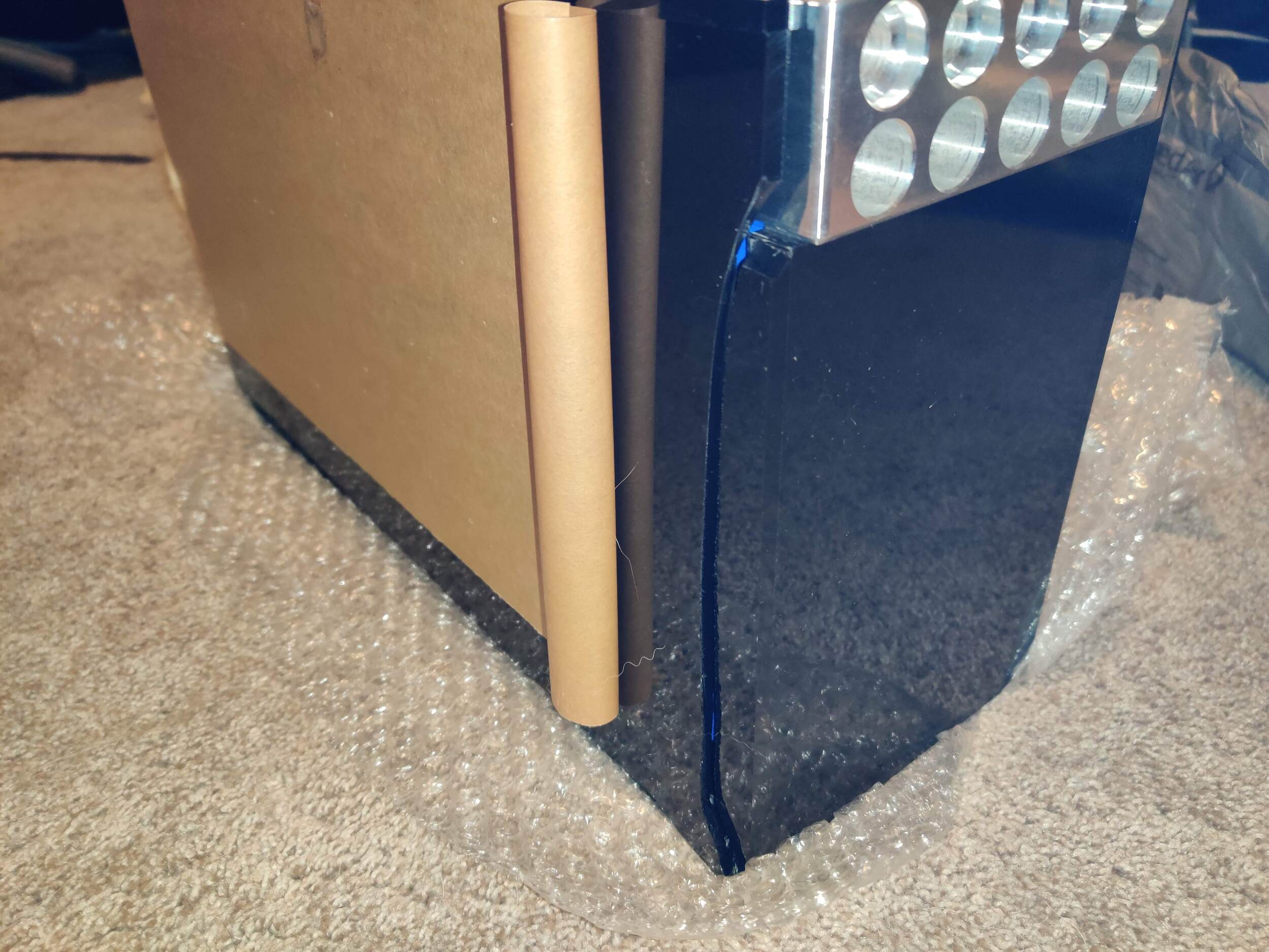

Arrived damaged, going to have to send it back and get a replacement. :(
