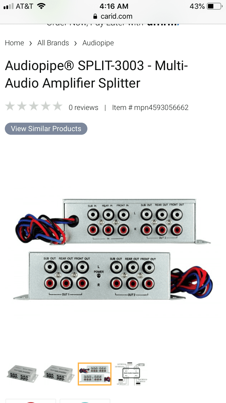

Ok I decided I’m gonna upgrade my 4 channel amp to the Rockford t1000x5ad along with this Audiopipe® SPLIT-3003 - Multi-Audio Amplifier Splitter, since no one can tell me about the LOC idea.
Then i can run the rear deck through my DSP???

It’s six channel, but sends full signal to all channels even in two or four channel mode mode so you can run your rear speakers on it and still keeps 2 rca channels for your sub amp. That five channel would have consumed all your rca’s, required that audiopipe module which was more equipment cost and potential to add another source of interference in your install. That said, how about reaching out to crescendo the makers of your brand new amp and communicating with them on the hiss and non functioning clipping indicator. Of the thousands of amps they’ve sold like all other brands including rockford I’m sure a few have needed to come back. Why try to trouble shoot on the forum?
