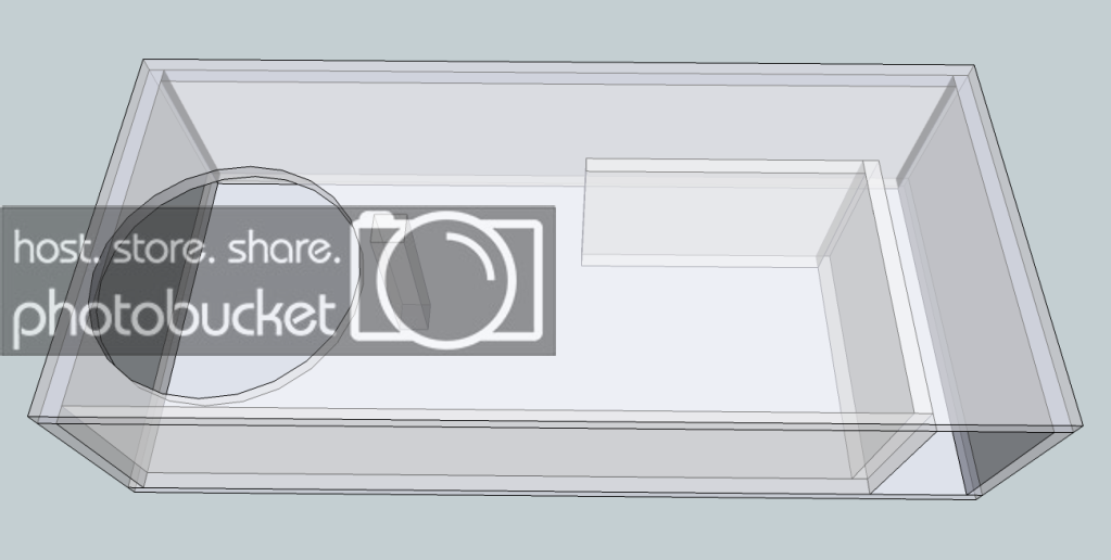

View attachment 26533562do something like this with a little less port...
That is similar to what I have, except for the port is faced back.
