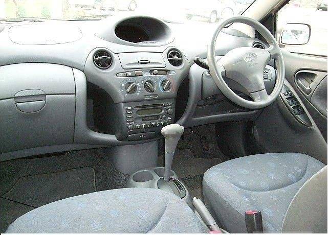

I have got Vitz (Japanese Model). I want to upgrade its existing sound system. As I don't like a lot of rattling bass, so currently I won't be installing an additional subwoofer, though I still want to have an amplifier powerful enough so that I am able to add one when I want. Basically, I prefer 'crisp' and 'clear' sound at low volumes like Bose has. I am looking forward to install a pair of 6-1/2" component speakers in two front doors, whereas a pair of 6*9 coaxial speakers on the shelf in the trunk.
