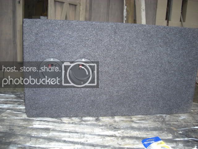

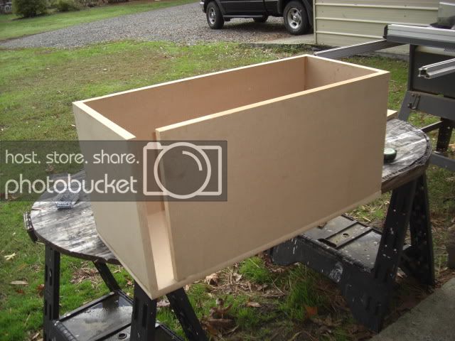

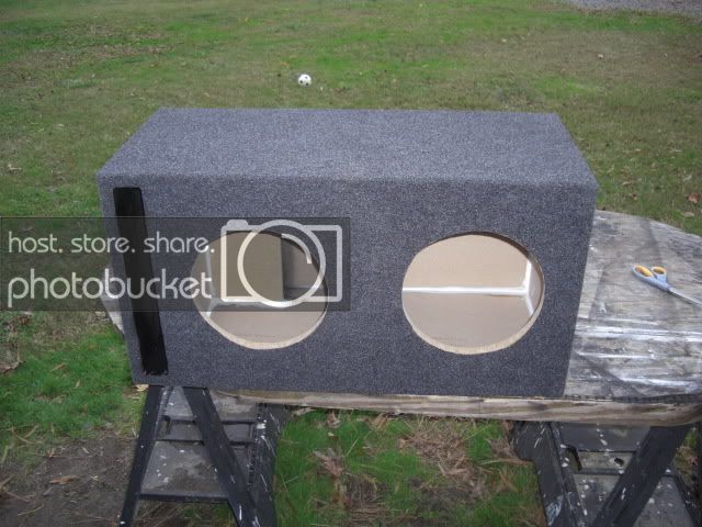

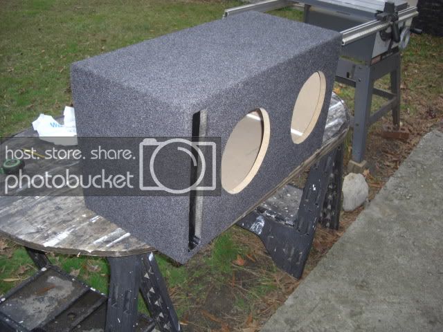

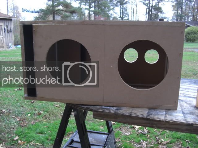

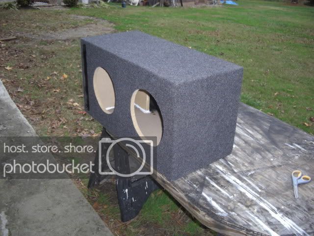

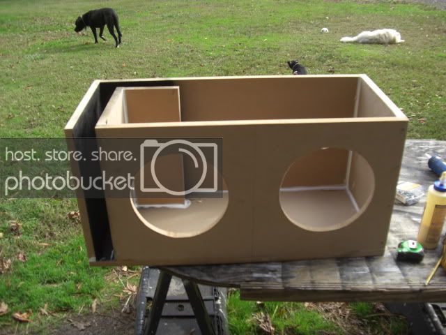

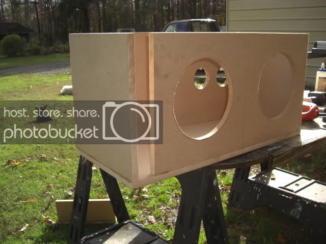

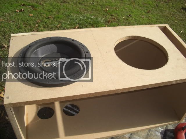

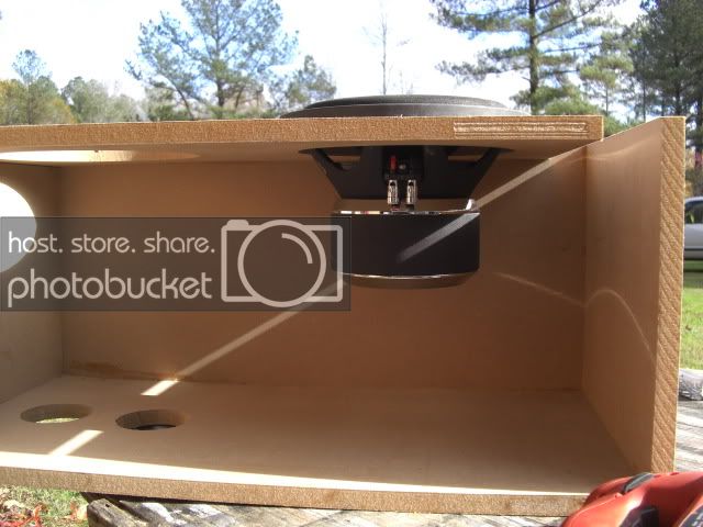

I know you wanted me to post up the build pics/etc here so here they are!
Enclosure is 2.67 cubes of airspace tuned to 34 hz. Has a 2" wide port with 29 sq. inches of port area. On to the pics!
Enjoy!
