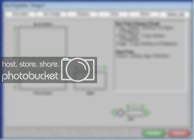

just to throw out a design having no idea what this is fitting in this is what is recommended by the mfg optimally everything exact except i swapped the square port to a 4" port to make it easier to build correctly.
Box Parts (Optimum Square Prism)
1 Top, 1 Bottom: 12.91 © x 19.97 (b) in
0.75 (thick) in
1 Front, 1 Back: 29.88 (a) x 18.47 (d) in
0.75 (thick) in
2 Sides: 29.88 (a) x 12.91 © x 0.75 (thick) in
Vent Parts
2 Ducts: 4.25 (ext. diam.), 4 (i.d.) x 10.62 (h) in
the PDF your pointing too is older than the one that i used that clearly says "updated" on it.
regardless 2 cubes is way beyond what a ported 10 needs, most 12's don't even need that much air space per sub,they are usually around 1.8-2 max.
while if you graph the performance it may look like the bigger box is flatter and goes lower in practice it just does not work as well and can even cause the power handling to go down on the subwoofer.

So lets go with your Dimmensions
1.65 / 38 / 10.5 x 1.25 x 16.75
Now explain how to turn that into a Dual Single Chamber Box
Box Parts (Square Prism)
1 Top, 1 Bottom: 20.59 © x 31.5 (b) in
0.75 (thick) in
1 Front, 1 Back: 11 (a) x 30 (d) in
0.75 (thick) in
2 Sides: 11 (a) x 20.59 © x 0.75 (thick) in
Vent Parts
2 Ducts: 4.25 (e), 4 (g) x 10.62 (h) in
external box dims are
31-1/2" wide x 12.5" tall x 20.59" deep
put to woofers on the 31.5 x 12.5 face as i assume that this is your truck your putting it in and i'd fire the ports out the same side or out a side if you have a least some space for the sound to escape.
fronts probably best though then you can try with the box firing to you or to the trunk lid. if you dynomat the trunk you likely will get a boost in SPL from rear firing the woofers/ports into dynomat
here this will better explain how each panel comes together
edit.
it would be a good idea to add a couple vertical braces betweent the top and bottom panels to stiffen them up. the other dims are small enough that they don't really need bracing imo.
