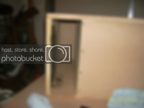

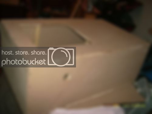

Well just finished up building the box, waiting on the sealant to dry. Ended up building it 36" wide 14" high and 22" deep. Port width is 4.5 ends up having 4.32 cubes tuned at 33.9. Ill post pics in a bit. Once dry and all I am going to rhino line it. I think I could have done a better job but I am happy with the results.
Well her eis a few pics this is before snding more to get out the rough edges. The rhino liner is drying right now so once that's done ill post them up.
