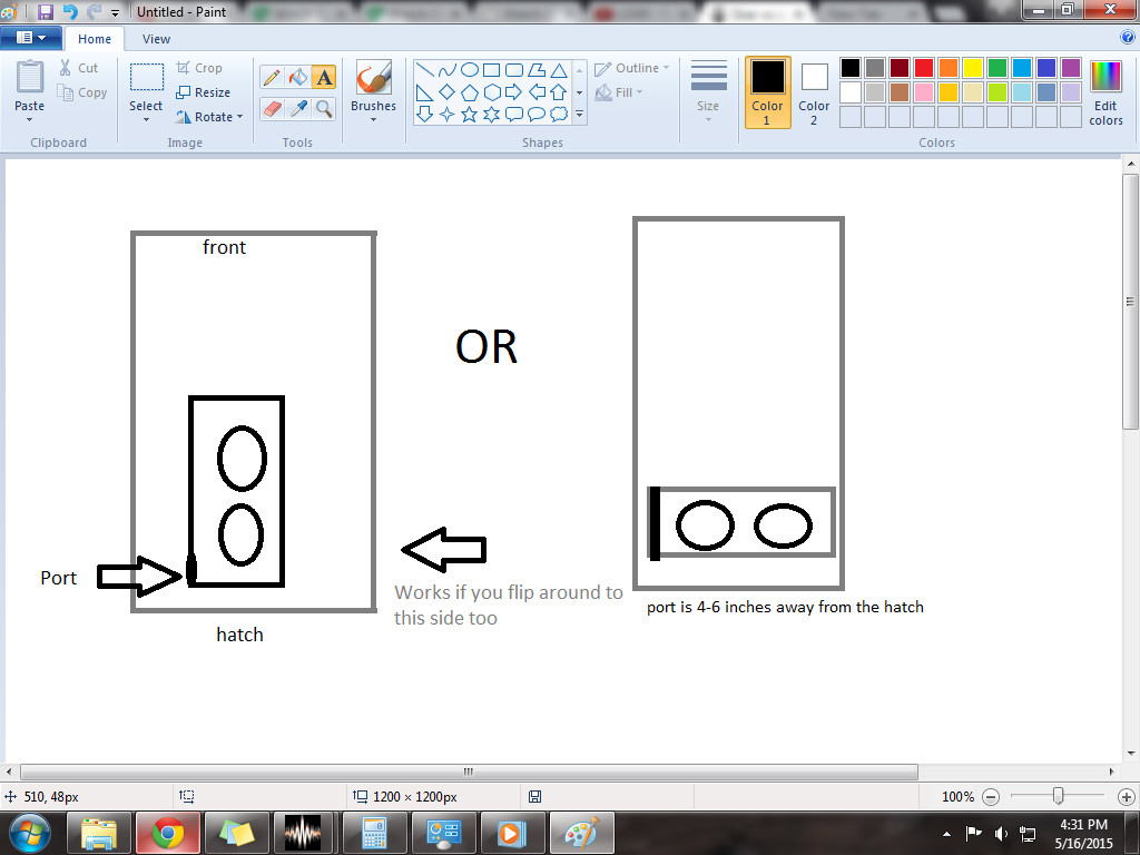

Yes Play with the box position, more importantly, the port position. The port is where all the sound is comming from, It needs to load off something solid.
Here are some ways you can flip stuff around.
