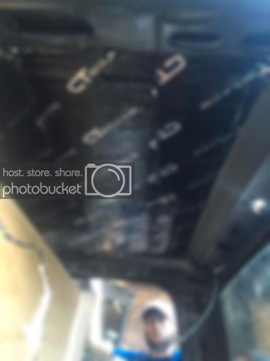

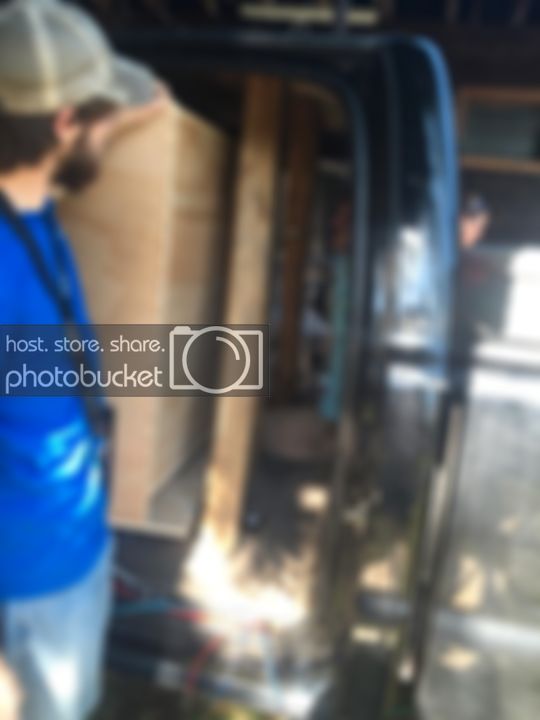

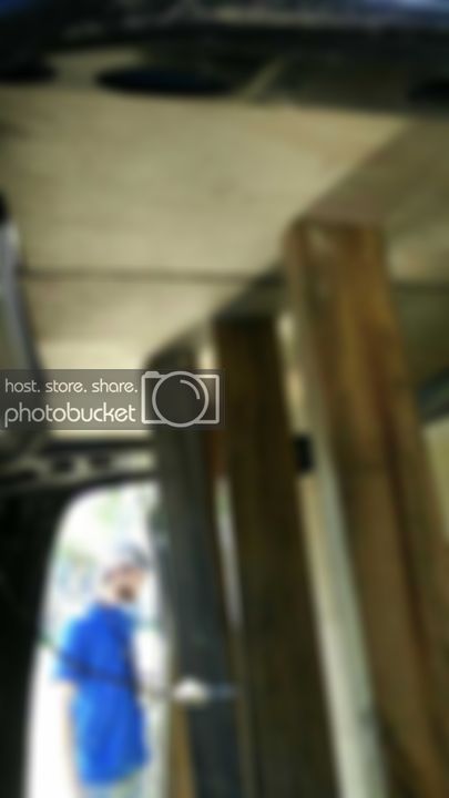

Plywood is a lot better than deadener for roof flex. I will be doing a few layers of MDF and fiberglass when I take my sunroof out.

I will put carriage bolts through the roof to secure everything. really don't care about looks. I want it to be solid enough that I can trust it as a mounting location for my next sub-amp.
There are several different ways to brace the roof with wood.

I did that with 1/4 in MDF and p&l xxx adhesive. It lasted half of a song and started coming loose and flapping and then falling off. So then I had to pry tthe left overs off my roof and clean the p&l off my roof. What a bltch that was. Then I put 48sqft of AT deadener and some American bass deadener, American bass was better IMO, and roof is pretty dang solid now. Some people have good luck with that I didn't. My new wall the top will be stuck to my roof with something the shop said.

Suppose to use 1/2 plywood and industrial strength construction adhesive and fill in the empty gaps with spray foam. Mines is still going strong, it worked better than 2 layers of deadener ever did for me.
