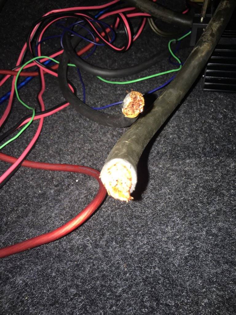

I received a skar rp 2000.1 on 12/29 played fine for a week starting last week amp had been going into protective mode, manual recommends 0 gauge and 200 amp fuse, I have 4 gauge and 150amp breaker, breaker hasn't tripped once, car must turn off then back on to go back to power, amp wired to one ohm. Is the small 4 gauge and breaker causing this?

Wire gauge requirements what they are, the amp would play fine at low volumes/low current draw with 8 gauge wire and a decent ground. If it's going into protect with a light load there could be a problem with a speaker or wiring.

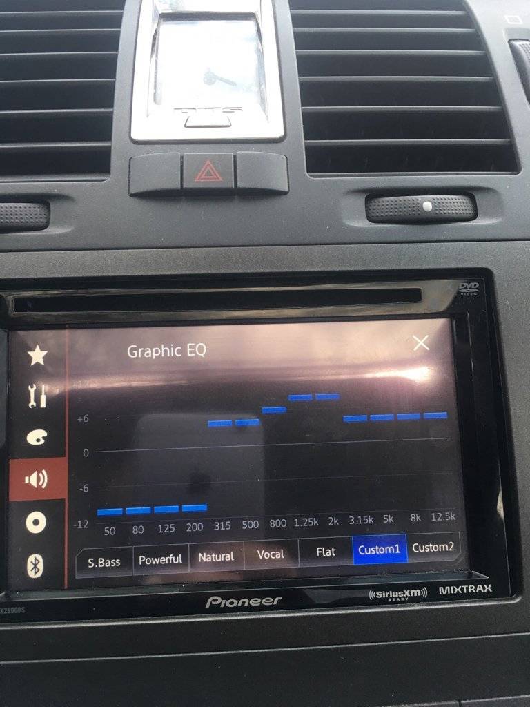

You head unit settings I MEAN ALL OF THEM, sub level, bass boost, loudness, volume max and current volume, head unit model, EQ settings, SLA, etc...

Pioneer avh x2800bs, 1 factory battery group 78, alt is 220a, taramps only accept 4 gauge n it's on a 150a breaker, no big 3, battery is under seat , far from alternator under hood. Sub level 0, boost 0, loudness off, volume max is 40, sla 0. When I had the punch 1000x2 on 2 sealed e 15s it never went in protective with same settings. I hd the skar on 4 gauge then I put it on 0 gauge same issues. Voltage stays at 14.5 according to digital dish display

you need to take voltage measurements at the amp pos and ground terminals, not what your dash displays. You dont have nearly enough battery power to support anything above 1500 watts. What brand of alt do you have?
Plus the battery far from the alternator would require big and thick dedicated positive and ground wire runs along with the big 3. Right now it looks like you have no proper power delivery or flow basically all your amps were starving from lack of real current. Your punch 1000.2 doesnt even come close to drawing any amount of currents your newer amps draw. You underestimate severely the amount of electrical upgrades needed to run bigger amps.

Ill throw in my 2¢. I just bought a taramps 3k and its very impressive. But it needs 0 gauge wire to run optimaly. Also with the taramps it comes with a clipping indicator. Ive noticed while tuning the gain and etc that only one or two volume knotches after clipping the protect light comes on. It doesnt take much clipping to do damage so it will protect to protect your subs. Tune to a 0db test tone at 80% of max volume with EQ at 0, not at -X. Meausre battery voltage under heavy amp draw and then you will have your answer
