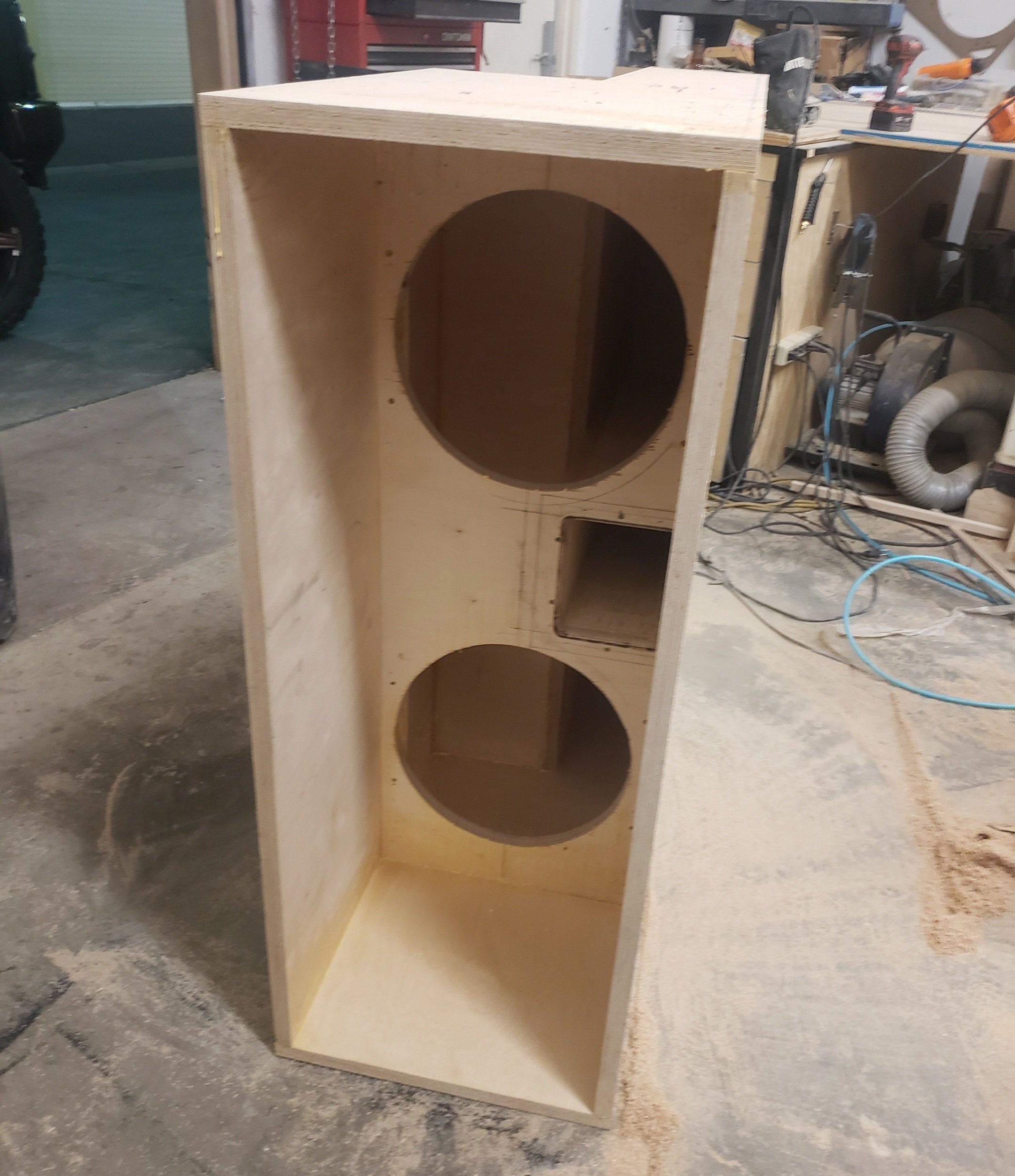

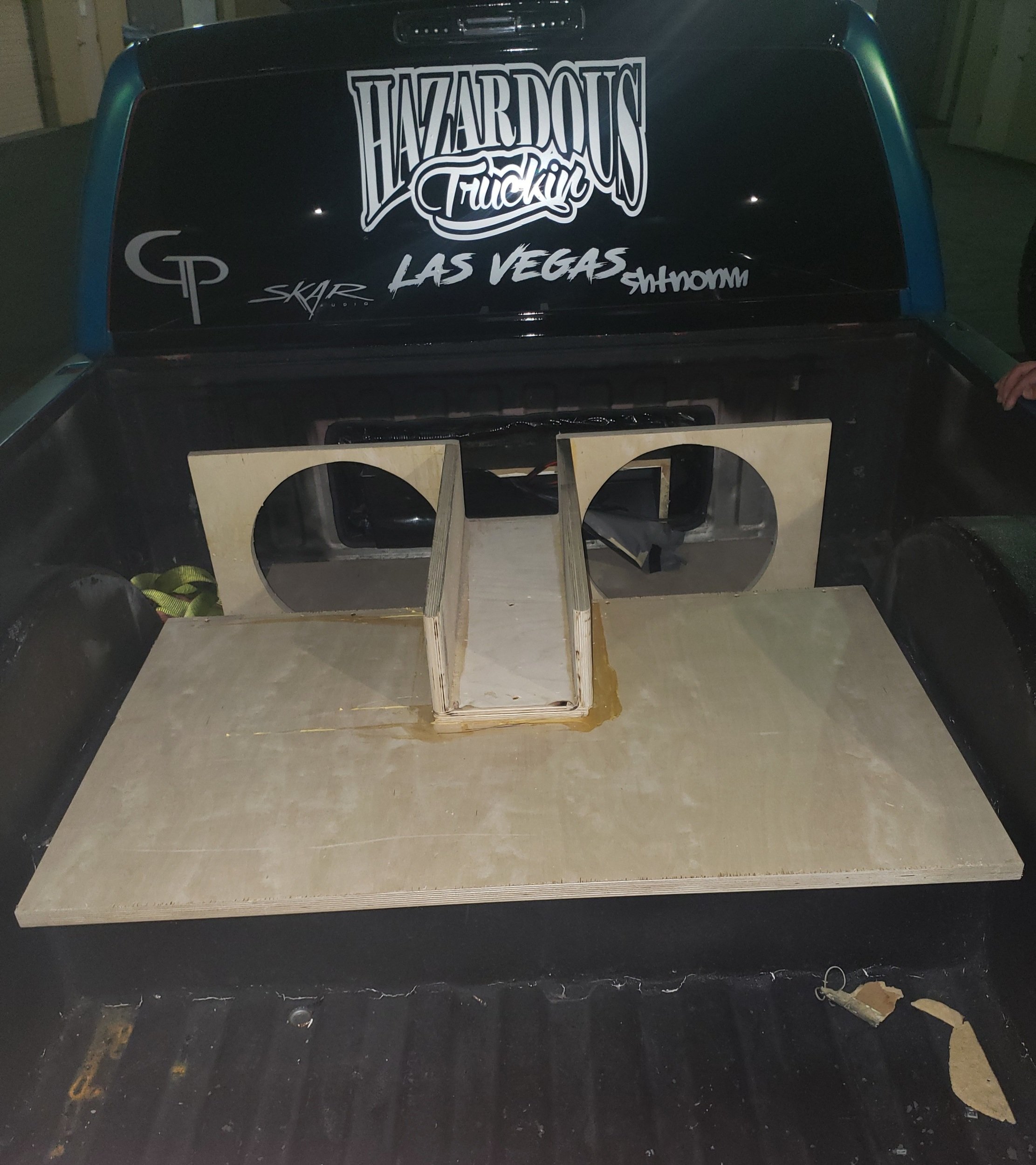

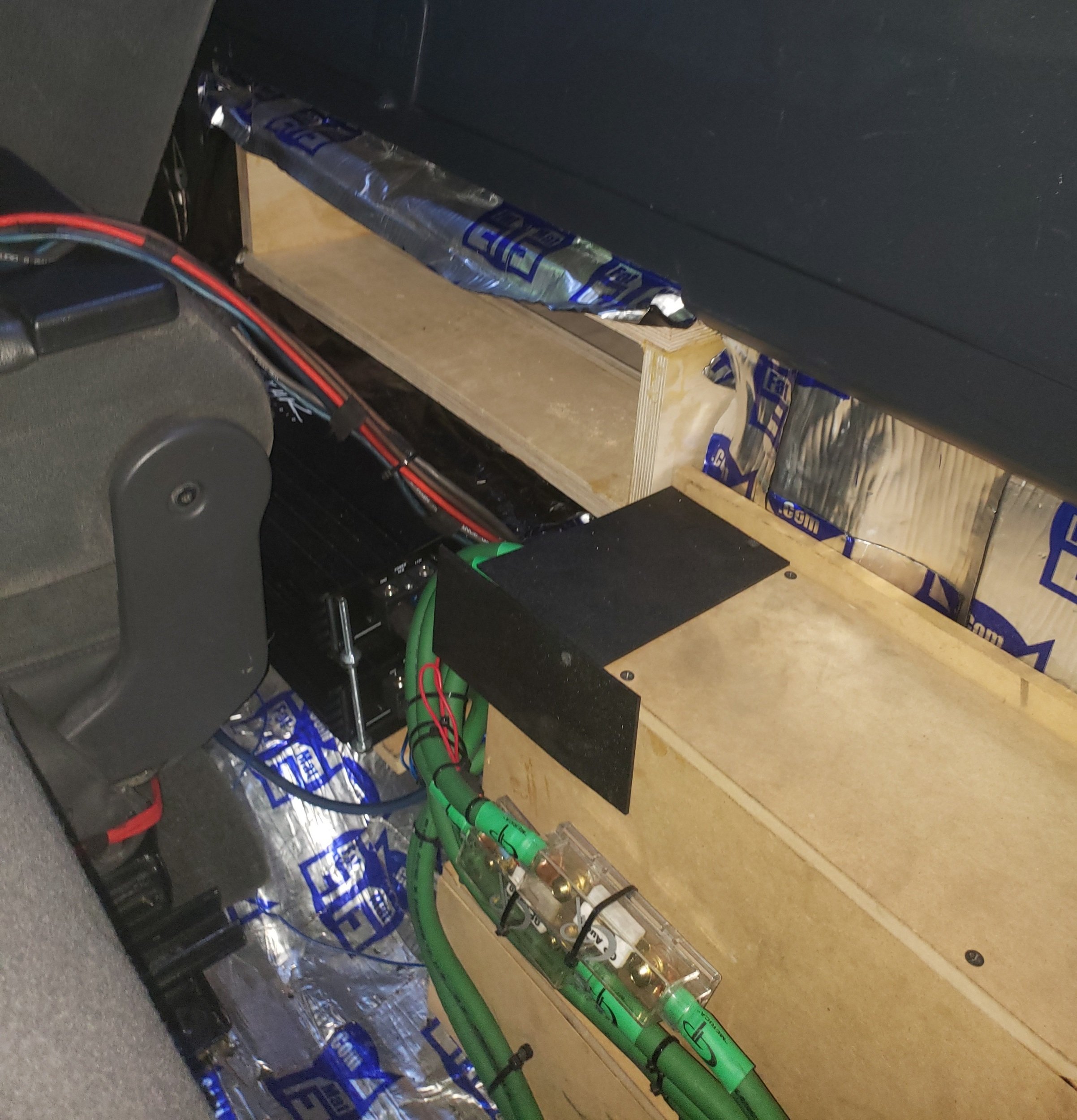

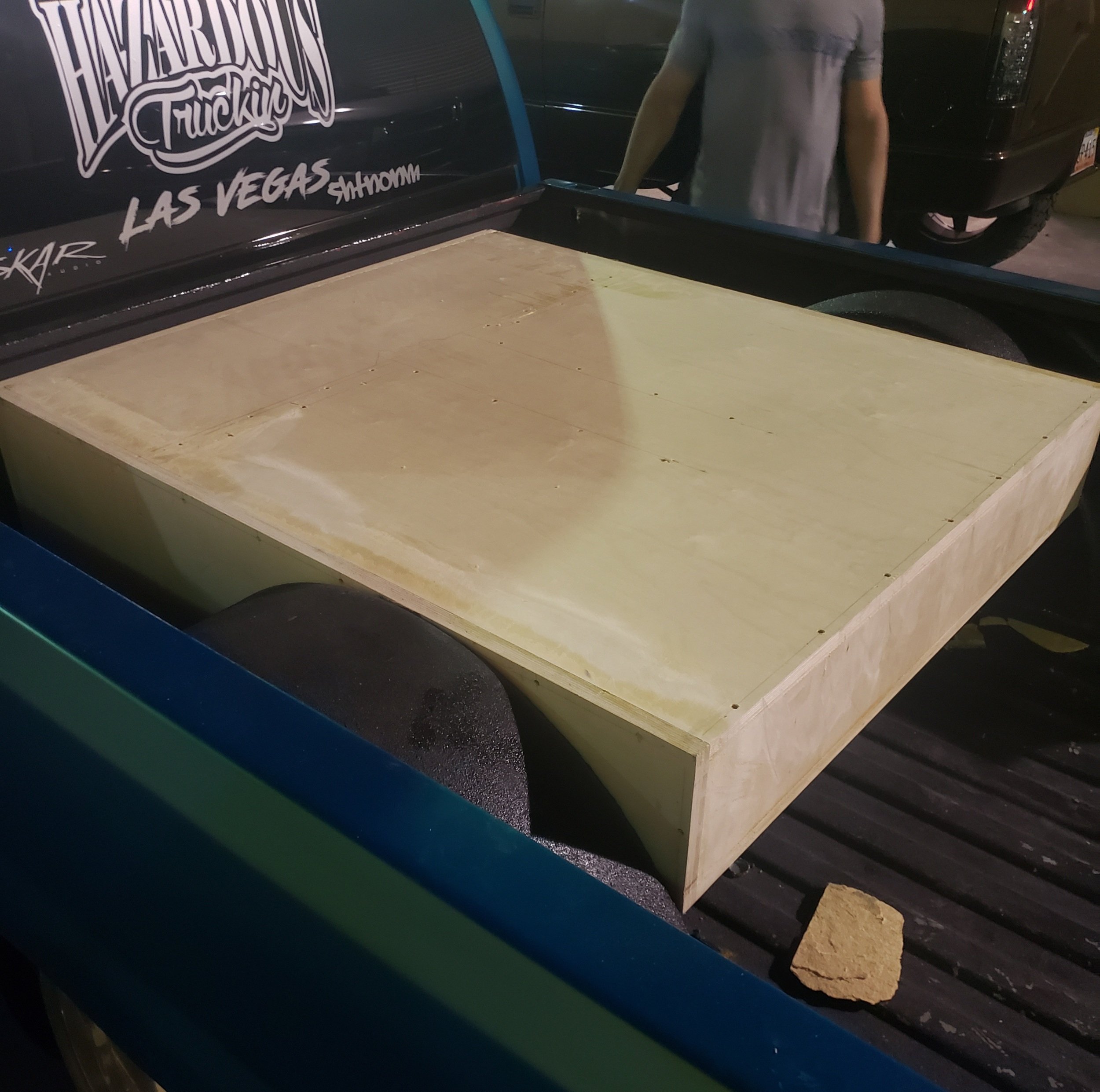

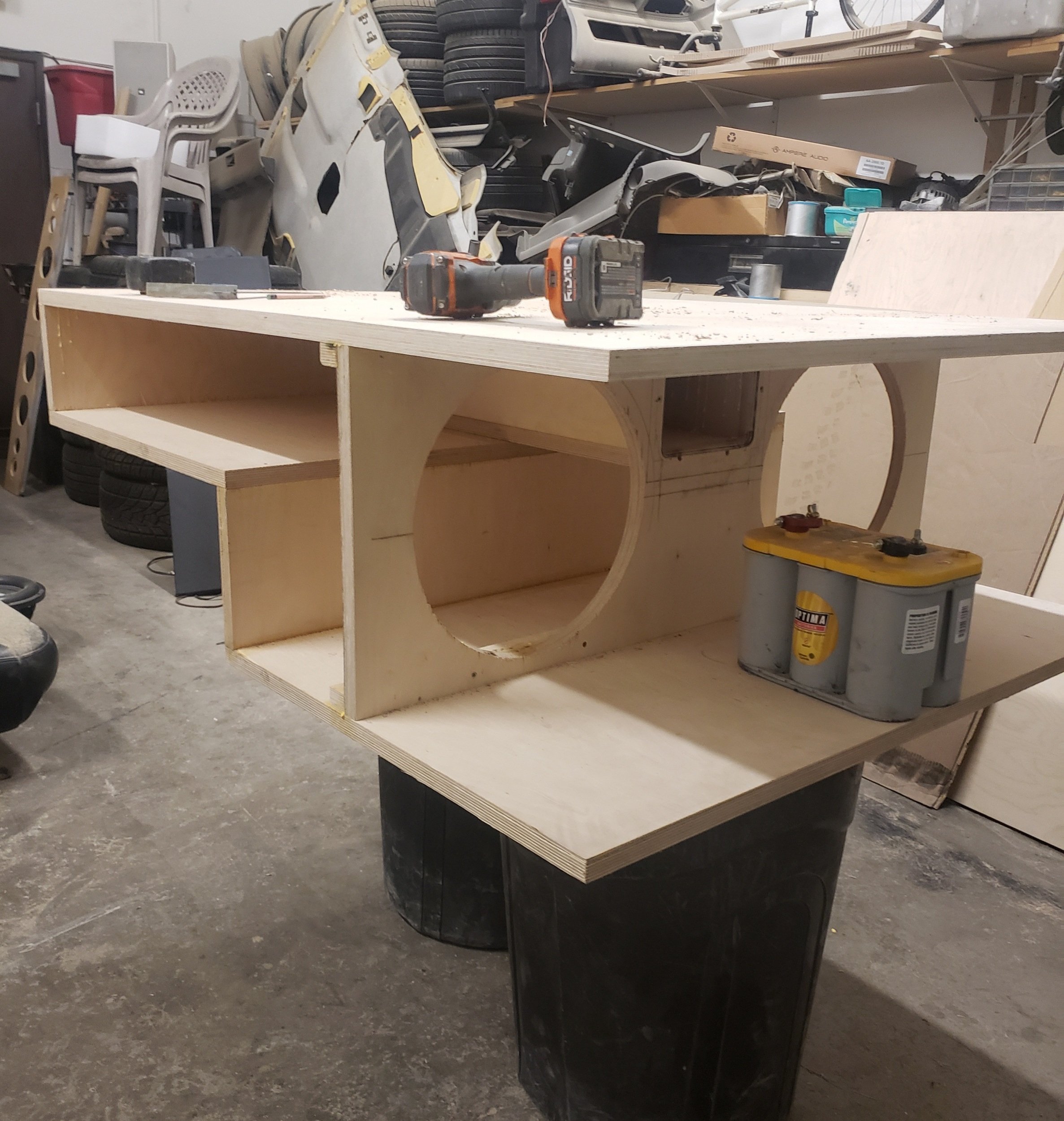

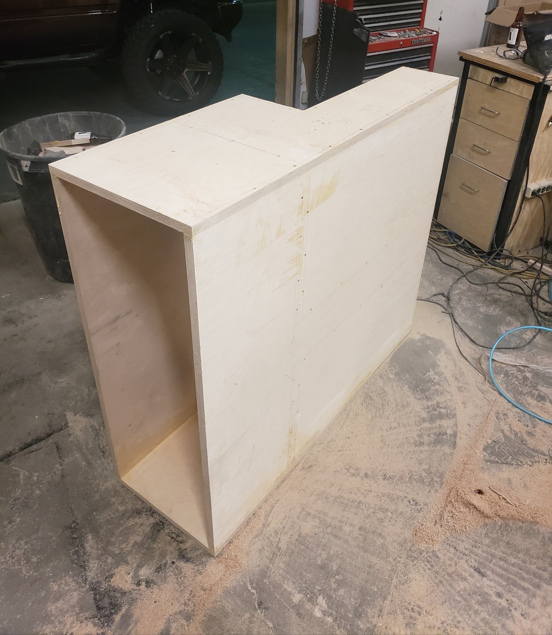

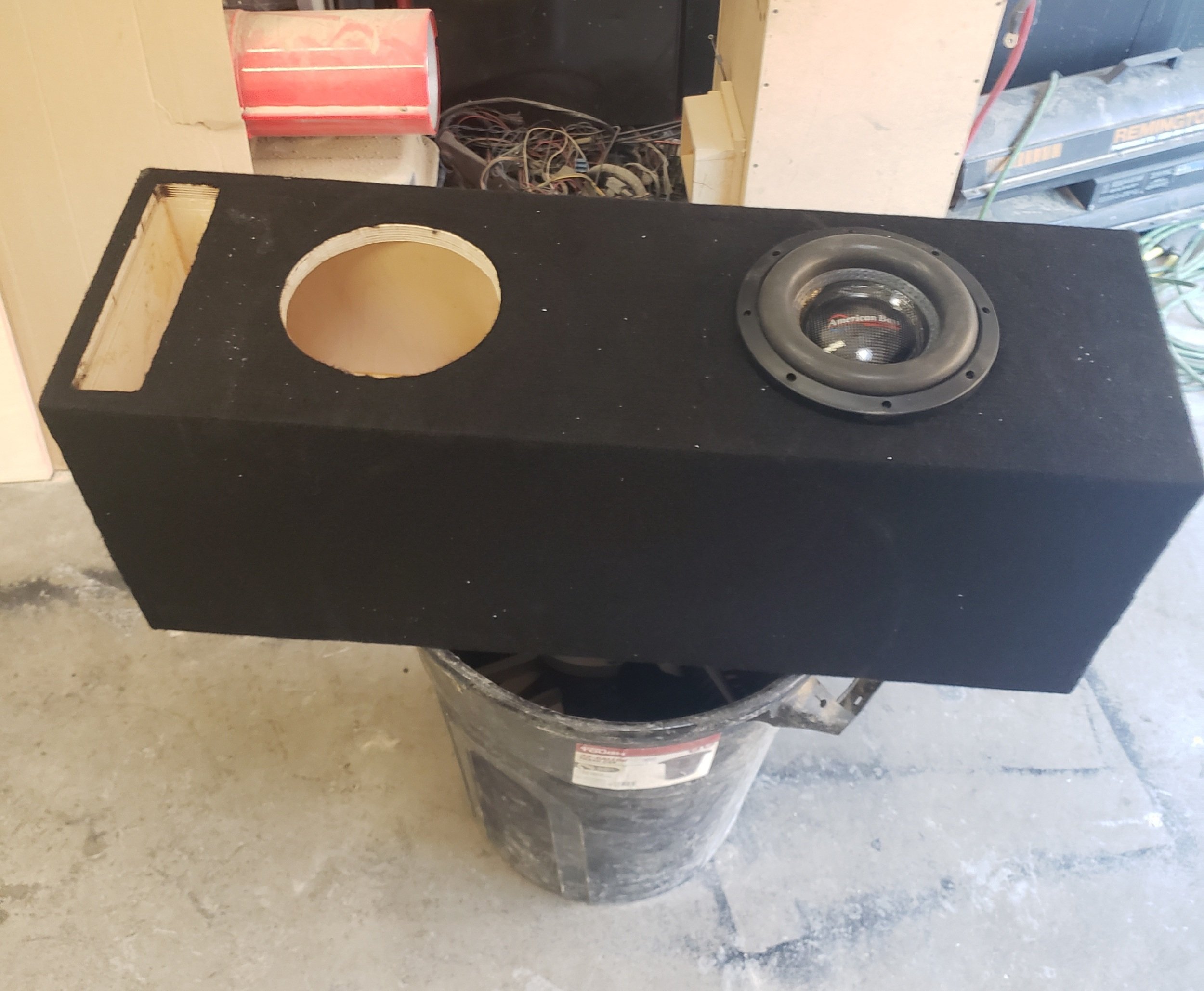

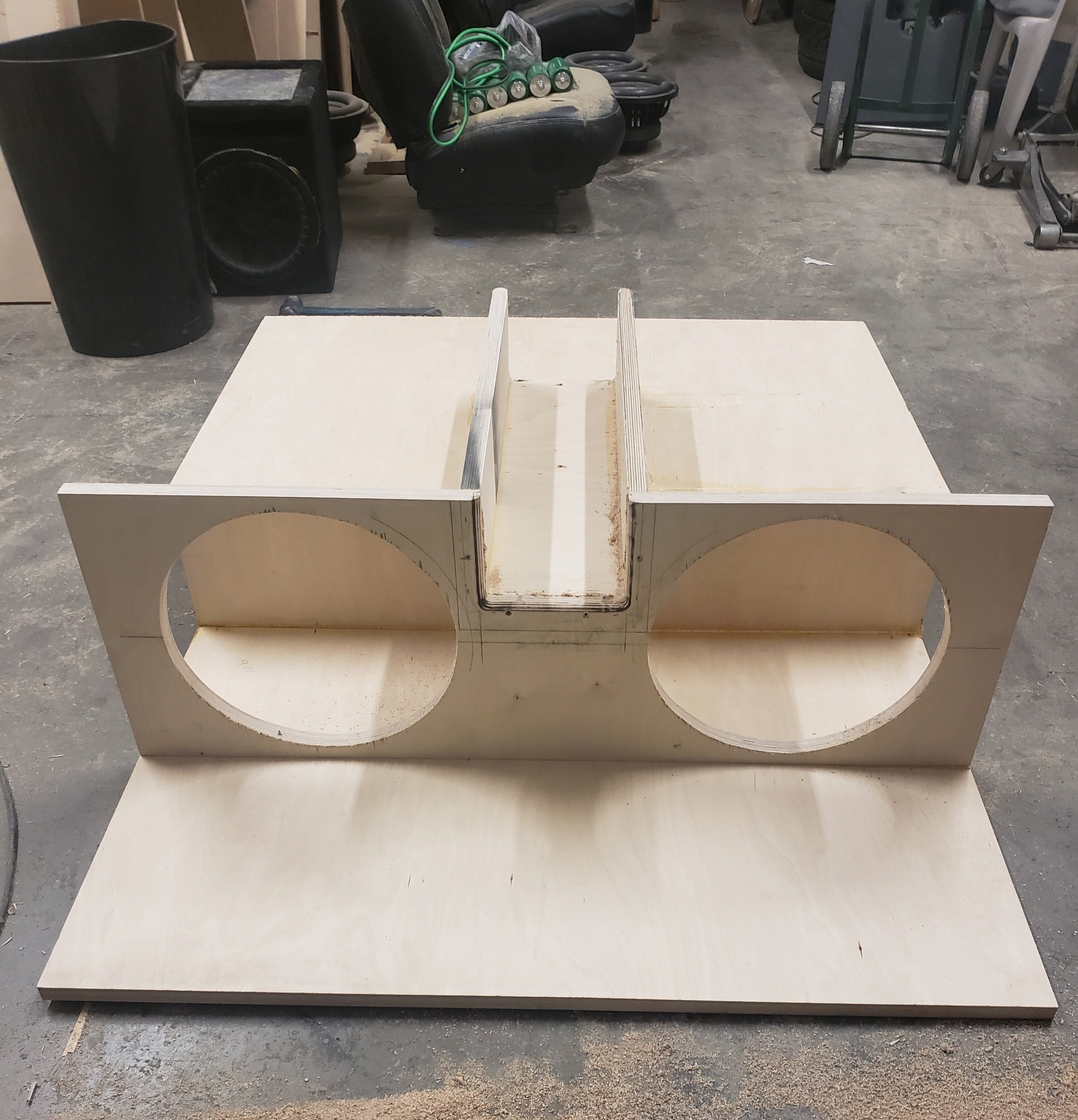

We built this last night. Sixth order blow through for an 03' Chevy standard cab. Tuning was 44 hz. and 22 hz. It was built for two Skar ZVX 15's. on 7K. He's going to Rhino line it and build a tonneau cover.
I didn't get a pic of the front port, but it seemed pretty big. I'll find out in a little bit. The guy wanted to be able to do hair tricks.
