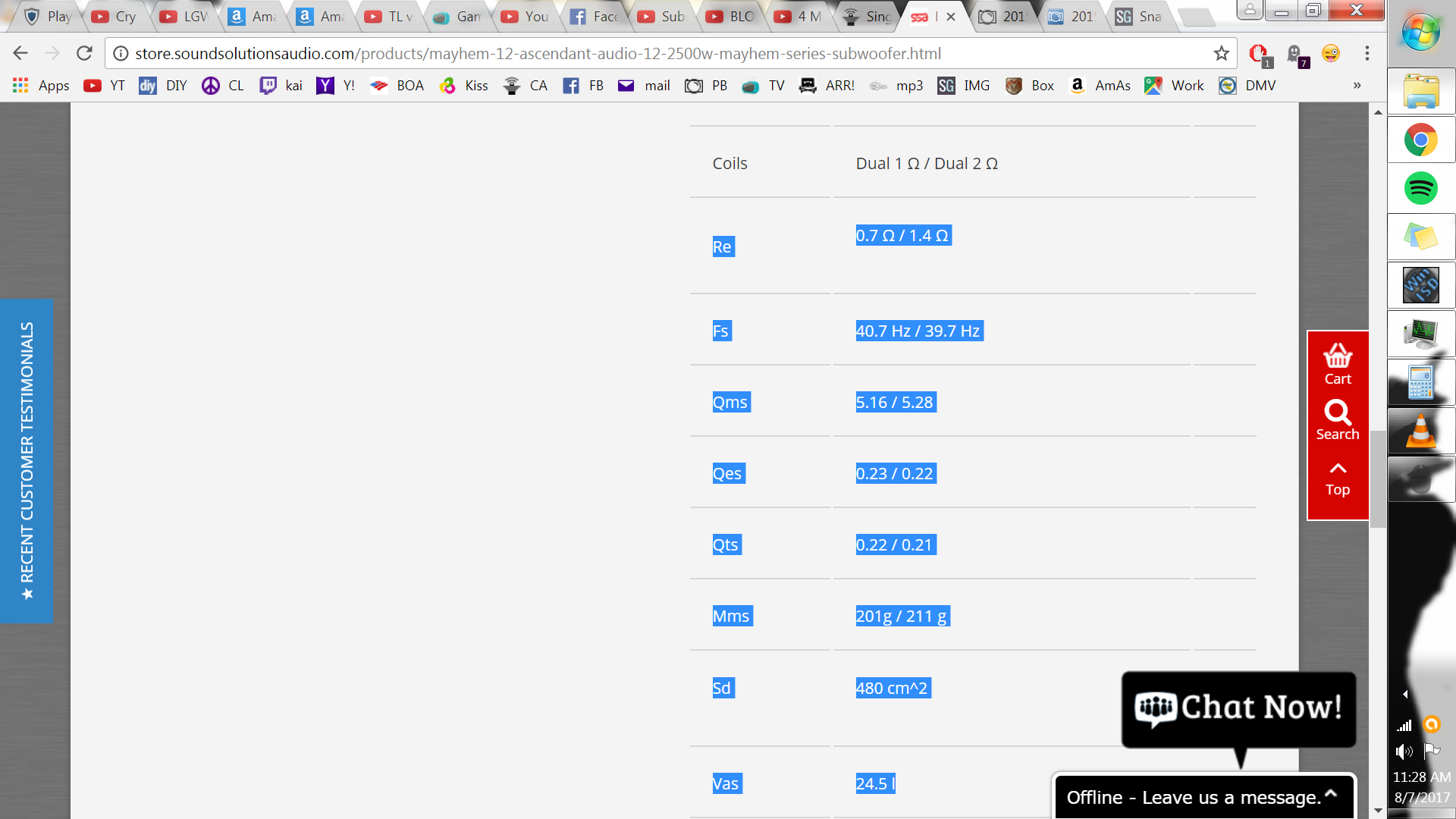

Go on and download Winisd alpha... watch this tutorial...

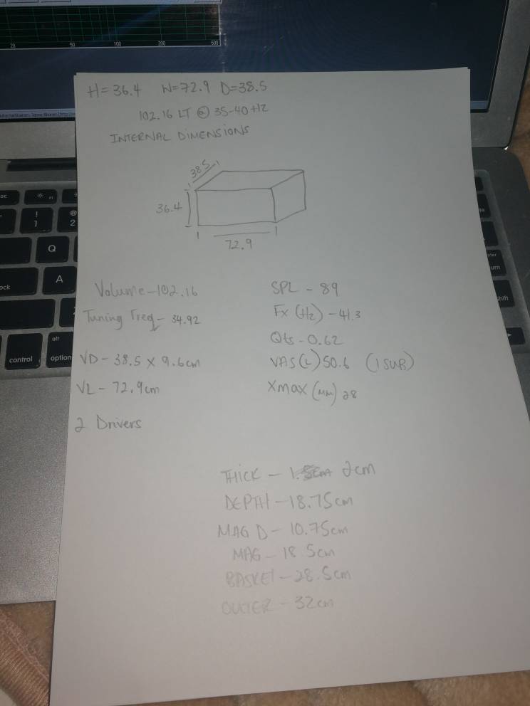

What do you mean by perameters shredder? I'm sorry for being a little slow I'll happily pass them onto you. I'v wrote down everything on paper as I went along an did my calculations... I made some adjustments an got the frequency down to 33.65hz.
Sent from my MHA-L09 using Tapatalk
The closest I could get my hz down to was 40. Since my port comes out at the top of the box.... I'll have to play a little bit more with my top depth to get the right port width. Lol I am very determined right now.

At this point I'm sorry for all of this... you're not ready to build yet IMO... Keep learning and an open mind and hang out on the forum and you'll learn a lot... you do NEED to get one designed or built as that amp you bought is going to find the limits of those subs easily... I'm only capable of modeling/Torres... I feel you need a set of plans in front of you... especially if you ask "what do you mean by parameters?"... you have not been listening apparently... I've asked, others have asked and you have plowed on straight ahead in your quest to tackle this YOUR own way... Re-read the thread and tell me you're actually ready for this... I'm glad you're willing to learn... but IMO you're NOT quite ready...

Not true man. Practice designing boxes but not building them. Then buy some plans and compare them to yours and see how the designer does it and how close you were. I bought my first design, now I design and build them all the time.
I wanted to build a t-line but I had a lot of questions. I designed a few and the I got a design from a pro (Stang on here) and I was pretty spot on when I saw his design.
There is a lot that goes into it. Get your designs on a 3-D rendering program so you can see them. If you pm me I can help you with stuff from time to time. There are people on here better than me, but I know the basics for sure.

Get a design and pick it apart till it makes sense... That's a great Idea Kam had... try to design a few then compare your efforts with the paid for design... heck it's only around $25-40 or so for a ported design... that's probably the fastest way to advance from your level... and as questions arise the forum is here...
Hell, I design one free. It may not be the most optimal design that will ever exist but I guarantee it will beat out any pre-fab. I can't design a pure spl oriented box without the vehicles peak, but I can design a good daily pounder that can kill the lows while also sounding good all around on normal music. I don't mind doing free ones when they are just typical rectangular enclosures
Here is an attempt to get really close...
Too bad you're in Austrailia I've got a similar for sale... sitting right here...
That design is probably not optimal but it's better than a prefab...
That's 15.5"h x 35"w x 28"d available?
Definitely better than prefab, there are 3 common walls tho, which might slightly change the finally tuning to be a bit lower, which is better in my opinion. Either way won't be audible likely.
Here it is with 3 common walls... It barely changed anything... just a fraction of a tuning change
