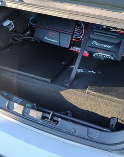

I used 2 - 12" subs in my trunk. I sacrificed my trunk, because I can fold down my rear seats if I have to do any rare hauling. I get more bass when I need it with the two. Your plan will work if you like the sound....... You can always add another later if you feel the need.
